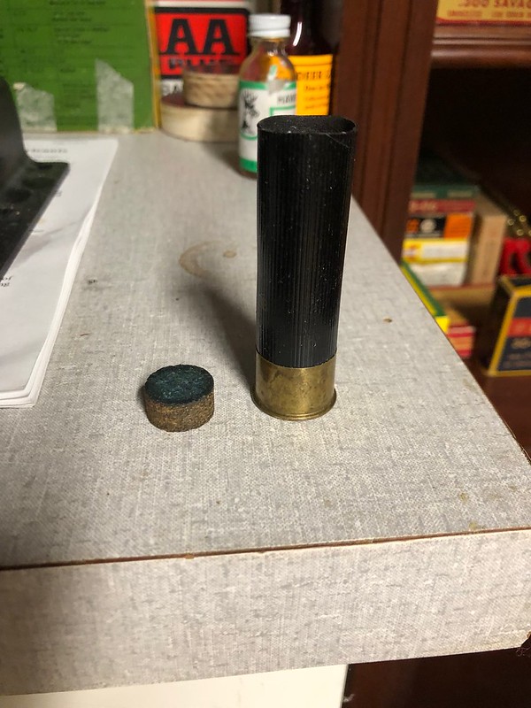

A Federal hull cut down to 2 7/8th's next to a factory 3.5 inch Steel shell with the Remington SP10 on the left and Hornady Versalite on the Right.
The 16 gauge filler wad.
Decent crimp.
My stash.
