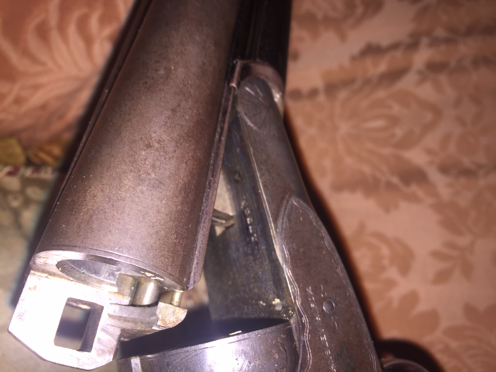

Hello. I am a first time poster. I hope it is ok to ask this sort of question here. I have come across an AH Fox Grade A 12 gauge for sale. Serial # 17xxx. Extractors only. They are asking $565 plus tax. Overall it is in good shape - the bluing is all there, though it is a little browned. A few splotches on the buttstock. A few small dings on the forearm. I don’t think there’s much, if any, case color left. The engraving is the same as shown for the early grade A on the Fox collectors website. There are 2 issues though. They are shown in the attached photos.

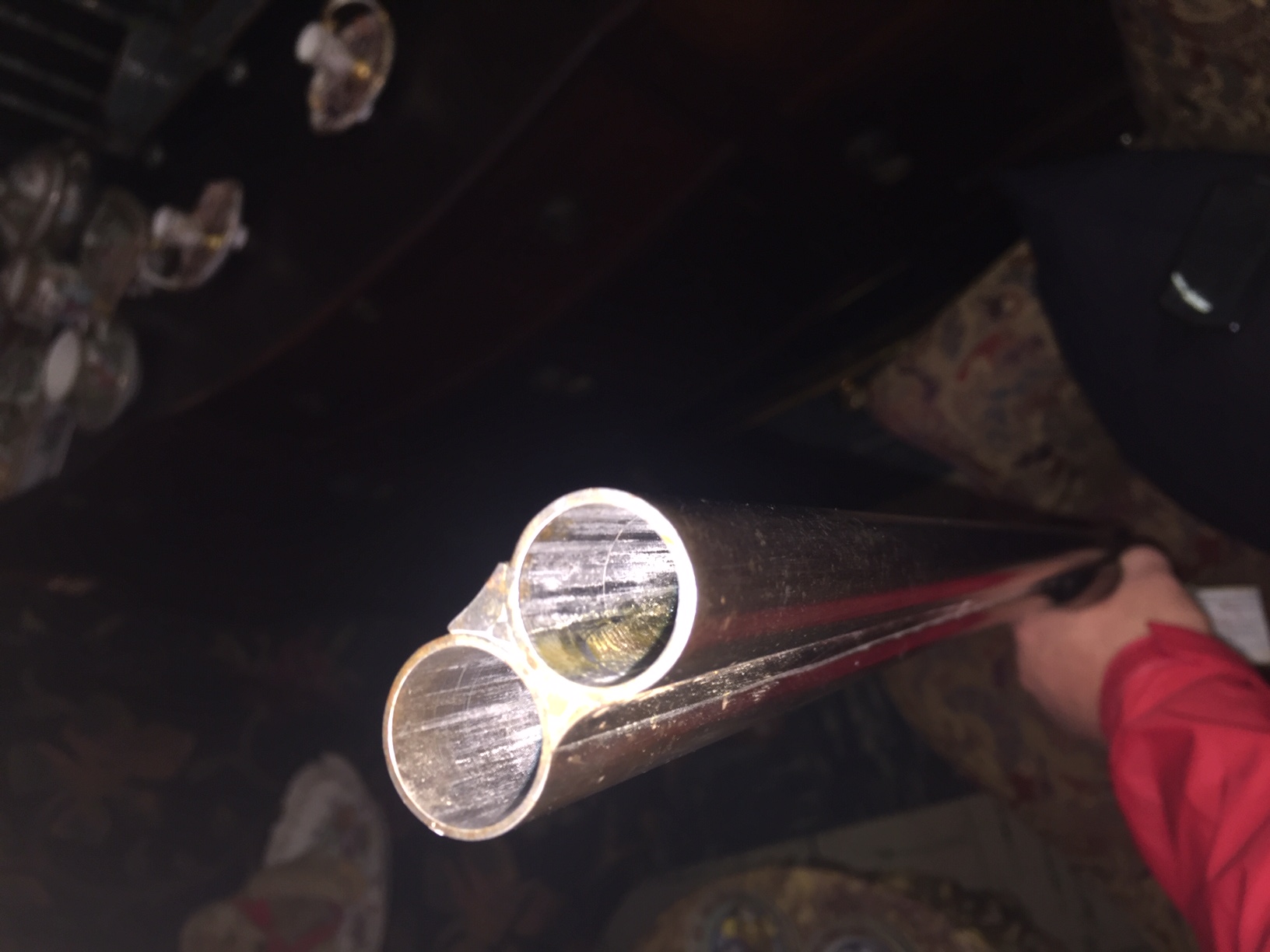

First, there is some discoloring or corrosion of the inside of the left barrel near the center rib. It’s not the color I’m used to seeing for rust, so wasn’t sure what it was. How much does this affect value and shooting?

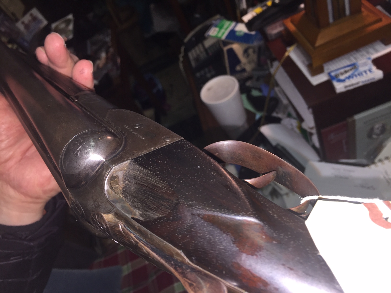

Second, there is a large chunk out of the stock at the breech / firing pin area on the right side. The stock is still very solid. Is this safe to shoot?

Run Away!!! Even without all the guns issues it is maybe a $700. gun. The material in the barrels appears to be epoxy.

Craig and Daryl - thanks very much for your replies. It’s a good thing I checked here first! I’m disappointed. I thought I had found a good deal. So you really think it is epoxy? I would never have thought that. So, based on what it is, is there an acceptable price for it or just forget it?

I suppose that could be epoxy but also could be something like varnish that dripped/ran down onto the barrels while someone was varnishing trim or woodwork. I've seen many old SxS's with drops of paint here and there and often wonder why the painter didn't move the gun out of the way. In any case it looks like the top barrel keel (steel filler between the tubes at the muzzle) is there, and the yellowish material is in the muzzle, not on the barrel ends as it would be for a mickey-mouse keel repair. Then again it could be paste soldering flux from a solder replacement of the lower barrel keel (which we can't see in the pic) but if so I'd wonder why the guy didn't clean it up. You haven't told us much about the specs nor the mechanical and cosmetic condition of that Fox so it's hard to put a value on it, but if you're good with wood that missing piece wouldn't be hard to fill in, reshape and spot-finish. If everything else checks out she might make a good "shooter Fox" after wood repairs. If so and if a common-featured early A-Grade why not offer something like $250 for it? Cash money or walk out the door. Of course all this will give high end collectors the jitters.
All this JMO. frank
