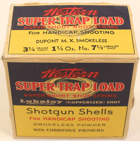

Western Cartridge Co. used the term "Super-Trap" on several different shells over the years. Originally on the Lubaloy shot handicap trap loads put up in their high-brass RECORD shell in 1929 and 30. In 1931 with the introduction of their non-corrosive primers they began putting this "Super-Trap" load in their lower-brass FIELD shell. In late 1936, Western Cartridge Co. discontinued manufacture of their FIELD shell, and in their December 1936 price lists these "Super-Trap" loads were available "subject to stock on hand" --
Super-Trap Load, Lubaloy, DuPont M.X. Smokeless.jpg (92.9 KiB) Viewed 31027 times
Super-Trap Load, Lubaloy, Hercules Red Dot.jpg (94.95 KiB) Viewed 31027 times

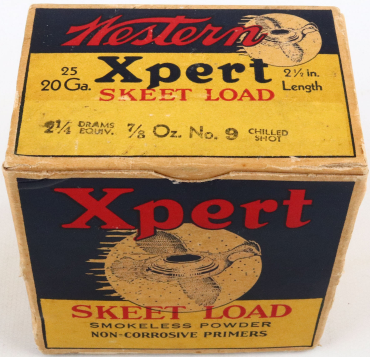

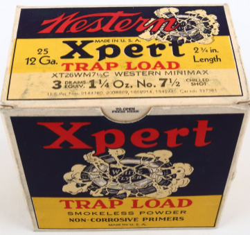

For 1937 to early 1939 they only offered their roll-crimped Xpert Trap and Skeet loads --
Xpert 12-gauge, 2 3-4 inch, Trap Load, Minimax, #7 1-2.png (273.84 KiB) Viewed 31027 times
Xpert 16-gauge Skeet Load.jpg (94.25 KiB) Viewed 31027 times
Xpert 20-gauge, 2 1-2 inch, Skeet Load, #9.png (297.58 KiB) Viewed 31027 times

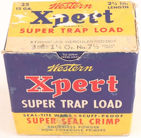

During 1939, they introduced their new Super-Seal Crimp on their Xpert Trap and Skeet loads and called them "Super Trap Loads" --
Xpert 12-gauge Super-Trap Load XT26HR7 1-2CS.jpg (112.24 KiB) Viewed 31027 times

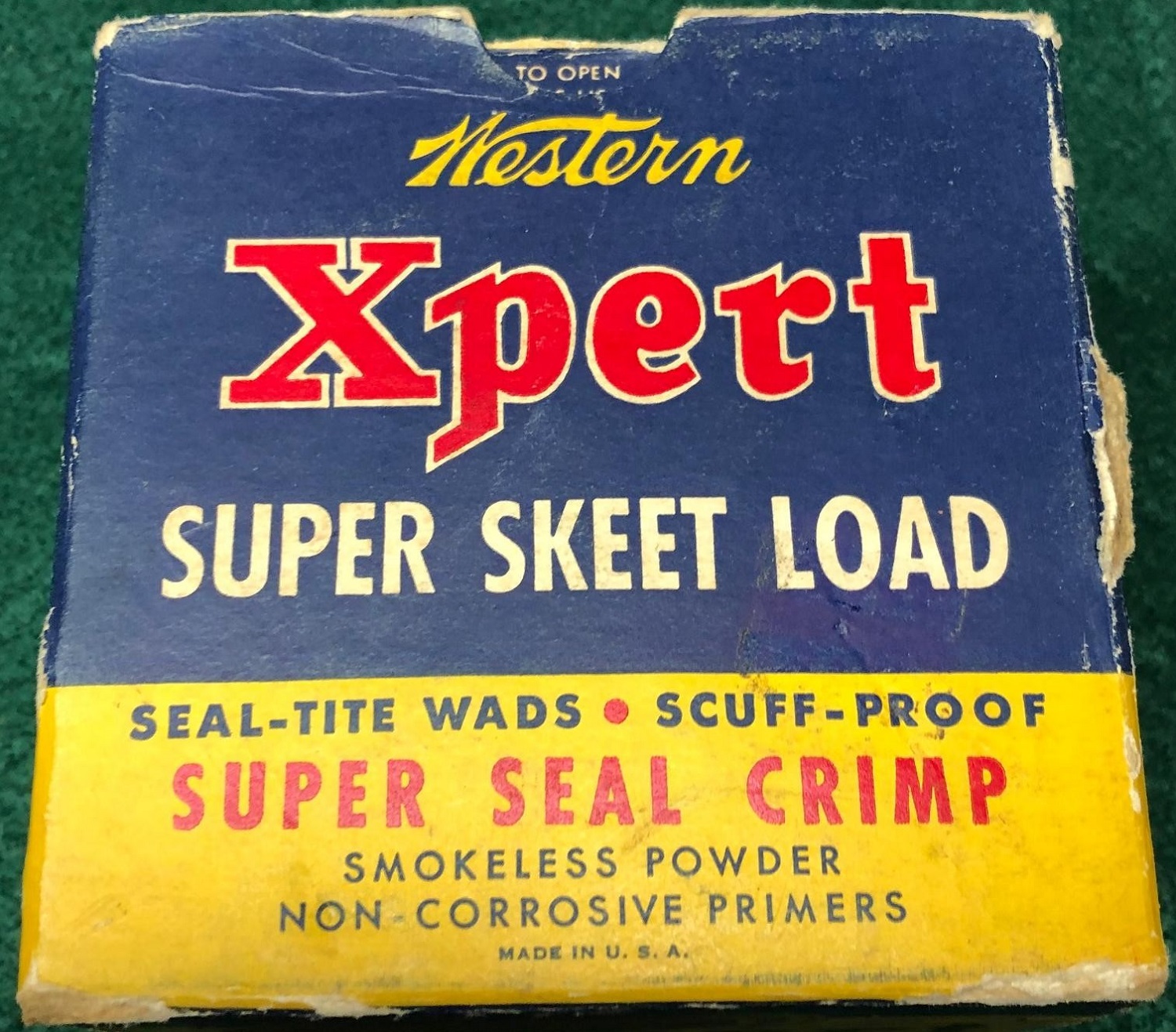

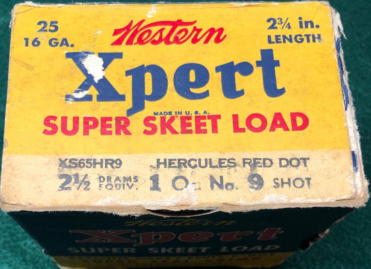

and "Super Skeet Loads" --

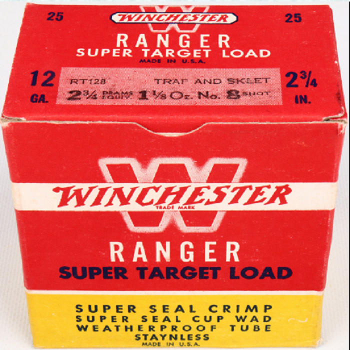

I, like you, Dave, am more taken with the Western brand than Winchester, but I have a question. I have a full cardboard case, one shell short, of Winchester Ranger, Super Target, skeet loads, paper shells. I have not turned the case over to look for clues. What can you tell us about those loads? They look like loads I shot when I was a teen or preteen, like 1958 or 1959.

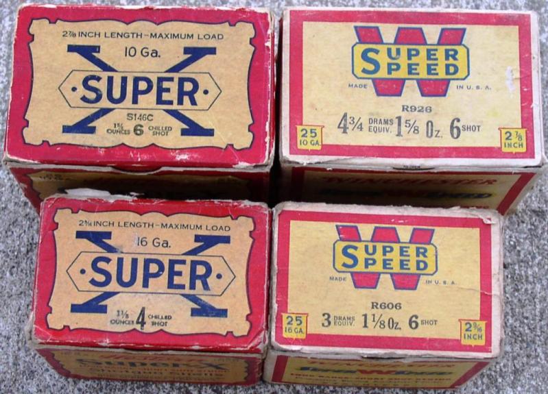

Essentially, within a few years after the Olin's took over Winchester, the Winchester shotshell line came to pretty much mirror the Western line, with a few of the less popular loads only offered in one brand or the other. Super-Speed/Super-X comparison mid- to late 1930s --
Winchester --- Western
Super-Speed = Super-X
REPEATER = FIELD (both dropped by late 1936)
LEADER = RECORD (the extra length and KopperKlad/Lubaloy Super-Speed and Super-X loads were put up in these high-brass cases into the early 1950s)
Ranger = Xpert
The December 15, 1954, price lists change from using the "Super Trap Load" and "Super Skeet Load" names to using "Super Target Load."
Posts: 3304
Has thanked: 89 times
Been thanked: 440 times
Re: Lubaloy Super-Trap Shells
My Super Target boxes are yellow with red and blue lettering, RT12M9. No description of crimp, but "Exclusive Sealed Gas Chamber" on right side of box.

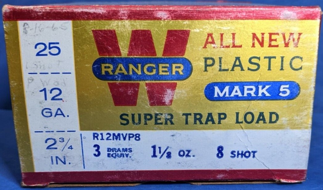

In 1963 they added the Mark 5 collar and the term "Super Trap Load" appears on the boxes again --

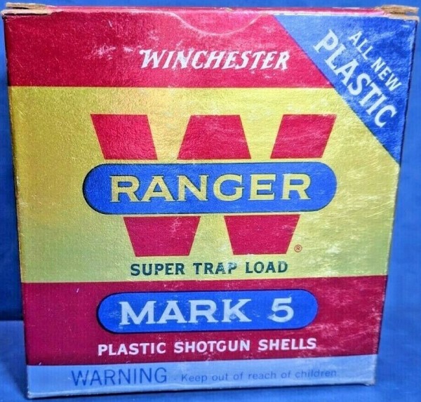

For 1964 they added the poly-formed plastic hulls to the offerings and offered the RANGER and Xpert, Mark 5, in both the plastic and paper shells.
