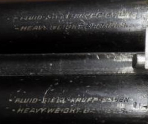

On the bottom of the barrels, ahead of the barrel flats, Is it marked -LIGHT-WEIGHT-BARRELS-?
We see the -HEAVY-WEIGHT-BARRELS- marking fairly often --
the -LIGHT-WEIGHT-BARRELS- not so much.

Yes it is. Krupp Steel, Light weigh barrels. It will need work for sure , I plan to leave it to my son when I can no longer get out.

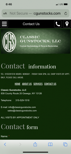

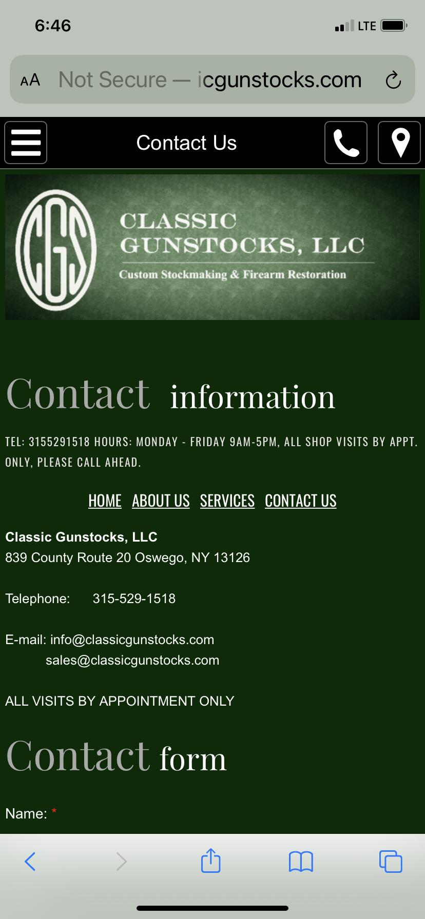

I have attached a copy of the contact info for the company I have been in contact with. I recently re did a Model 21 with Connecticut Shotgun. They did a wonderful job, nice people as well.
“I’m upstate” was supposed to be “ in upstate” NY.

Agreed, Classic Gun Stocks are among the best. They also excel in single trigger work.
Dan May and Ken Waite are as nice as they come.

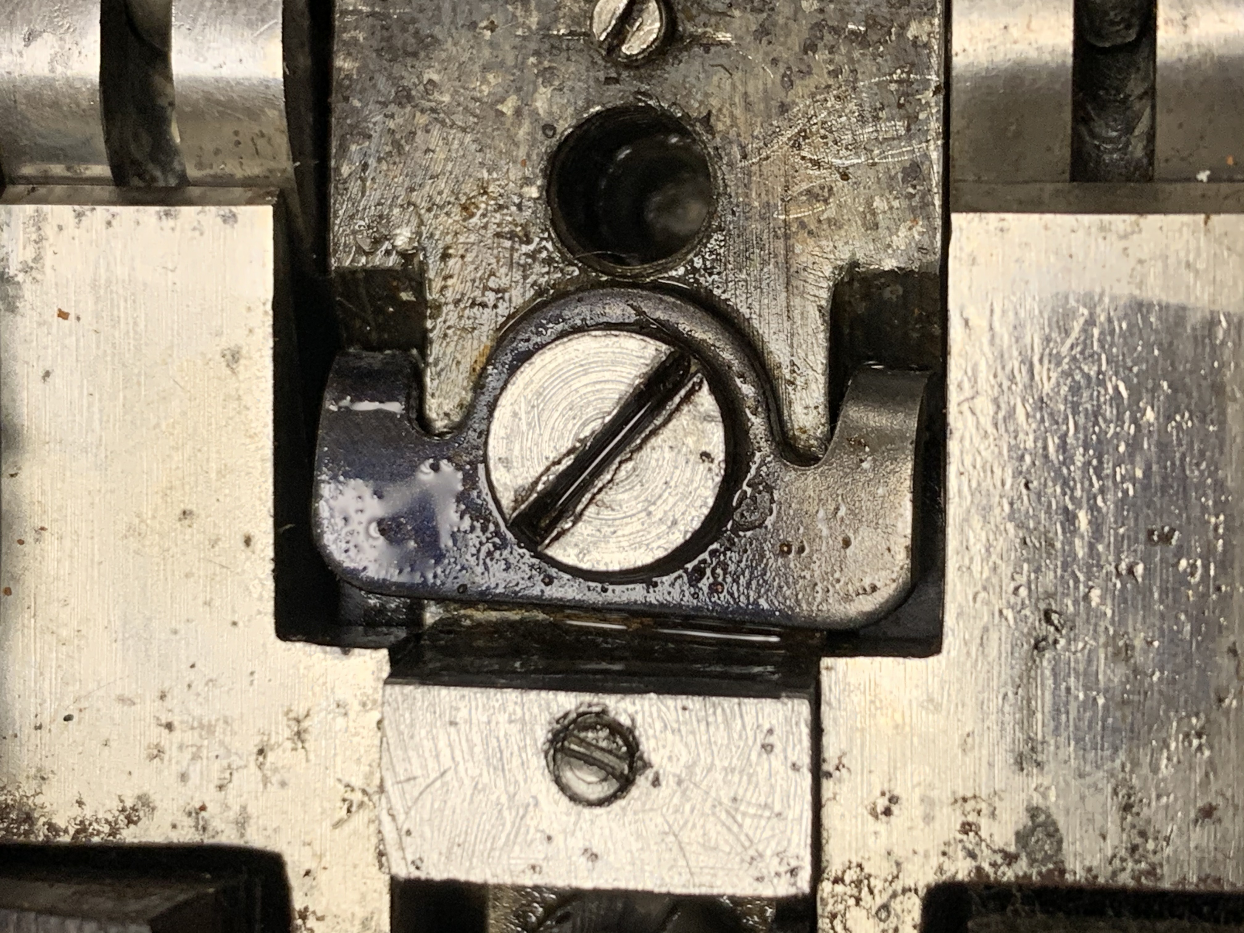

I ha e attached a photo of the Rear Axle screw, it appears from shot I am seeing is the gun has been taken apart before, I am trying to get the SMALL rear axle screw out so I can get the stock off.
It is so tight that I broke the head off of a small screwdriver typically used for eyeglasses.
The screw will not turn , I have some oil sitting on over night. I read the disassembly process, this was a great help !!
Need some expertise from you experts !!!
