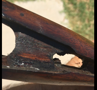

Tom was correct. Imagine that. Out of the 18 pictures I took only 1 shows some of the repair. I just need to get a real camera. The photo show the added reinforcement. What it doesn't show is the epoxy on the other side. The repair looks ok to my untrained eye. This gun will never see full power loads. If it breaks firing low pressure shells I'll just have to deal with that.

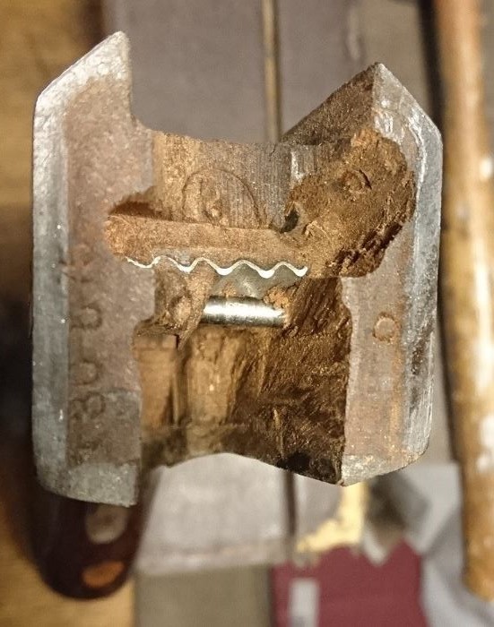

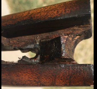

Interesting repair. Here is a picture of a staple repair. One of the long serving members here (Frank S.) provided this photo to the best of my knowledge. I have had a failure or two of my own guns in this same area and they were repaired using acraglass by a pro.

Thanks Tom for the reference but that's not my pic; in addition to a cross-pin it looks like some goof gouged out the "pyramid" that draws the stock head to the frame when all the screws are tightened. That waffle staple is factory original and was done by Fox on some but not all stocks, to reinforce the web from lateral pressure as in a fall while hunting etc.

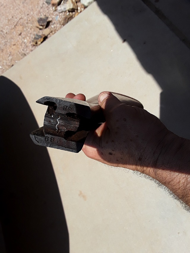

Interesting Tom that the staple is factory. The one picture I had didn't really show the amount of repair that had been done after it left the factory. I have a video and might be able to get a couple of screen shots.

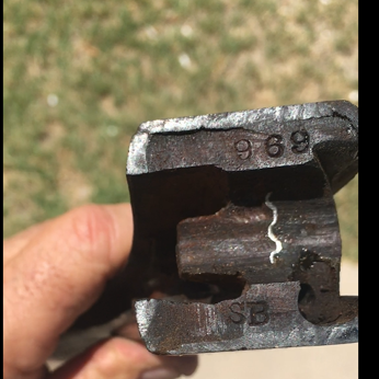

Here are some pictures of the remaining part of the repairs done to the wrist of the 20 gauge. I had to screenshot from a video to get these as my attempts to photograph them outright was a miserable failure.
Better picture of the staple
Staple 1.png (286.8 KiB) Viewed 10190 times
Block
Block
Block 1.png (255.08 KiB) Viewed 10190 times
Tang
Tang
Tang 1.png (249.42 KiB) Viewed 10190 times

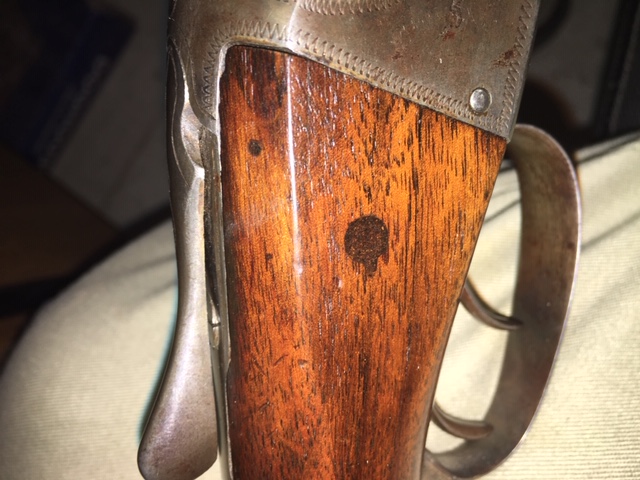

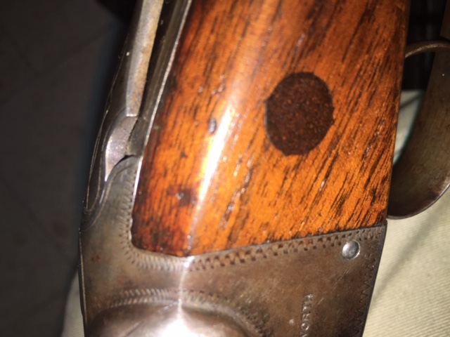

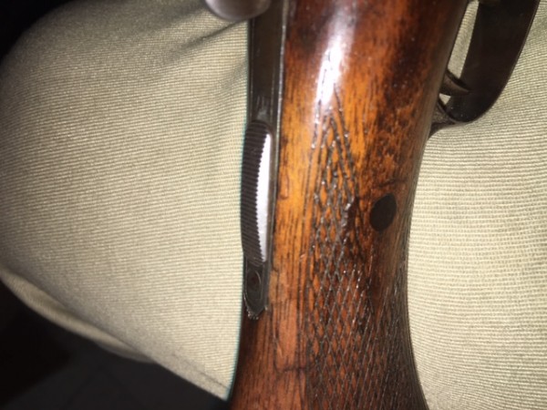

The more I look at the photographs the more I'm thinking that the only repair done to the wrist of the 20 gauge is the addition of the plugs/reinforcements. The photographs inside the stock look more like old dried oil than a repair.
What do you think?
