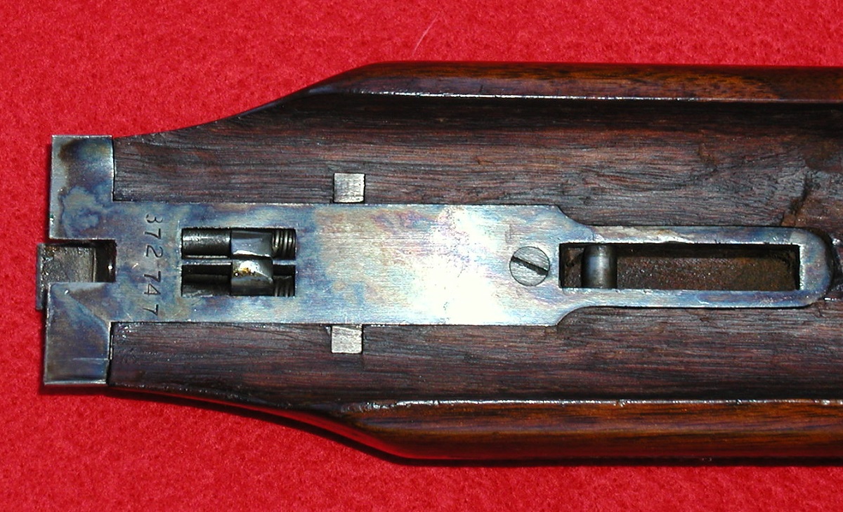

I think the cross brace in Silvers forend it the best indicator or originality. Most if not all aftetmarket beavertails I have seen do not have it. And it is necesssary to retain the wood in shooting the gun. I am not positive, but I think some braces carried the serial number of the gun.
The brace is the metal that protrudes on each side of the forend iron when looking down into the forend off the gun. About 1/4 x 1/4 on each side, towards the rear. The screw from the rear of the radius goes into it. The brace is one piece and goes around and under the forend iron and ejector springs.

I call it a yoke. It is certainly the norm on Savage-era ejector beavertail forearms, but I have not seen it on extractor guns with beavertails. On the other hand, I've also seen them on quite a few slim ejector forearms, all six of the Savage-era ejector forearms I own, four slim and two beavertail. Here you can see the yoke on the forearm for my 12-gauge Fox-Sterlingworth Ejector Skeet & Upland Game Gun --
They are certainly superior to that Philadelphia era woodscrew into that very thin web of wood in ejector forearms.

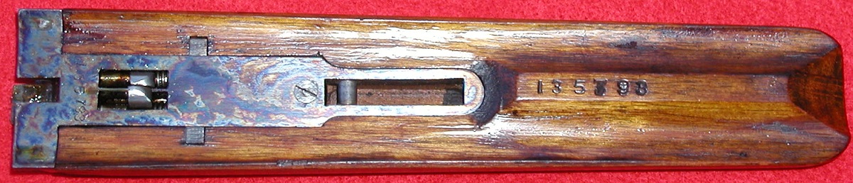

Another example to consider. The following photos are of an '83 Bielin restock of which no notes are included in the receipt as to the style requested. I am left to conclude that this is an example of Mitzie's standard for the era rather than Savage's last style. BTW, the blue and the cyanide colors are Mitzie's (or sub'd) and the BT forend set the owner back $25. If anyone is interested I can share more of the work and the rates.

Bird, thanks for taking the time to post. Your info adds much to our knowledge of Mitzie's work. Just wondering, does your forend have the crossbrace feature?

If I am correct, no. My third picture does not match Researcher's example of a cross-braced forend iron (second from right). Am I right?
Also, I mistakenly thought that my gun was an ejector when I viewed pictures prior to purchasing it. The escutcheon led me to this error. Am I right to conclude now that properly stocked/assembled SW extractor BT forends utilize the escutcheon as the extractor forend iron attachment?

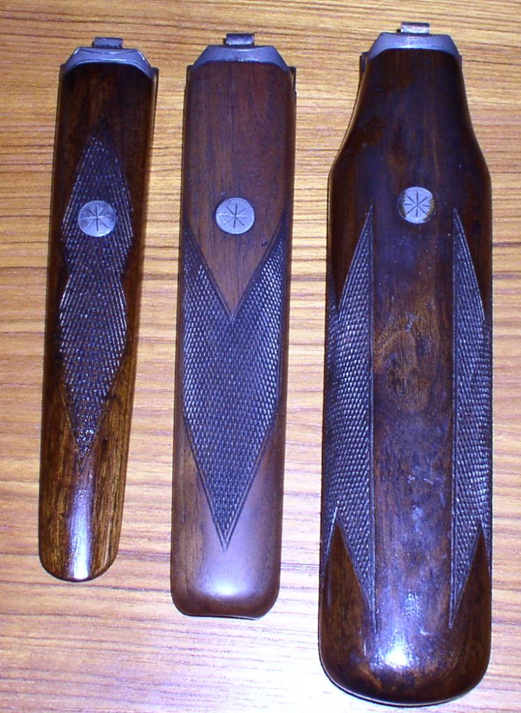

Bird, yes the crossbrace is as shown on Researcher's pics, second from right. Also as shown on the past pic I posted on page 1 of this thread. Sorry, I don't know the Savage era factory norm for screw anchors in extractor beavertail forends on Sterlingworths. I don't remember seeing one I thought was righteous.

No, the crossbrace/yoke has a different purpose than the anchor/escutcheon. Crossbrace and its machine screw keep the forend tight against the front end of the ejector f/e iron knuckle. In comparison, the anchor was typically used as the forward attachment of the ejector f/e iron on SW's and some real early graded smallbores.
Here's a crossbrace setup that came on an ultra rare 1-frame Super Fox that was rebarreled at Savage. Just to show how the machine screw provides the tension. That's a better setup for ejector guns than the regular wood screw, same opinion as Dave commented earlier.
