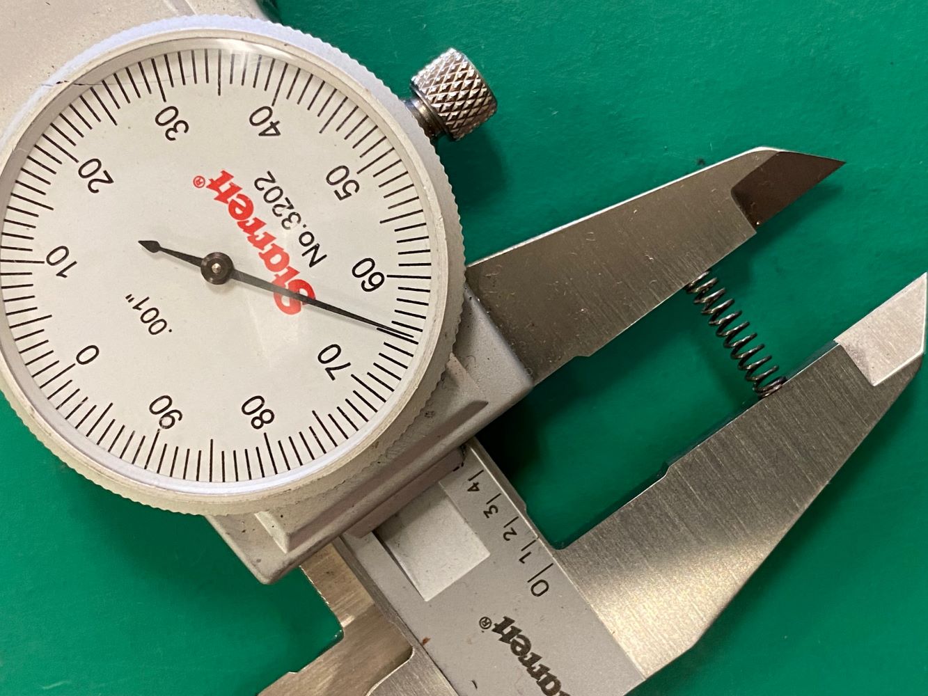

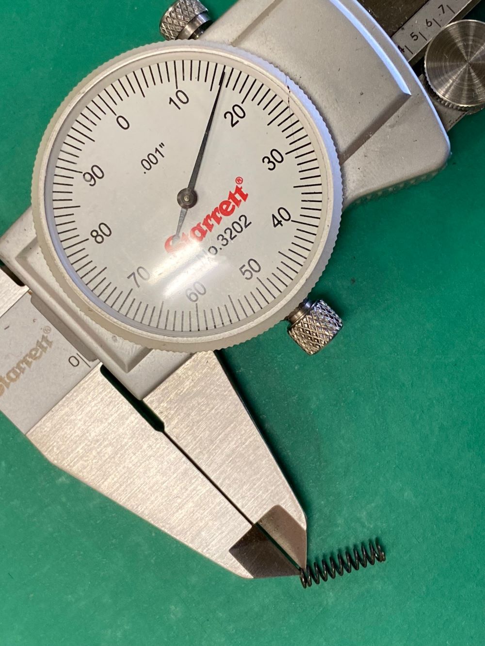

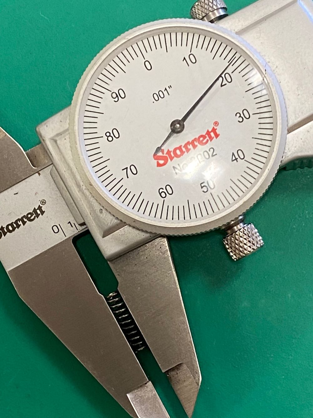

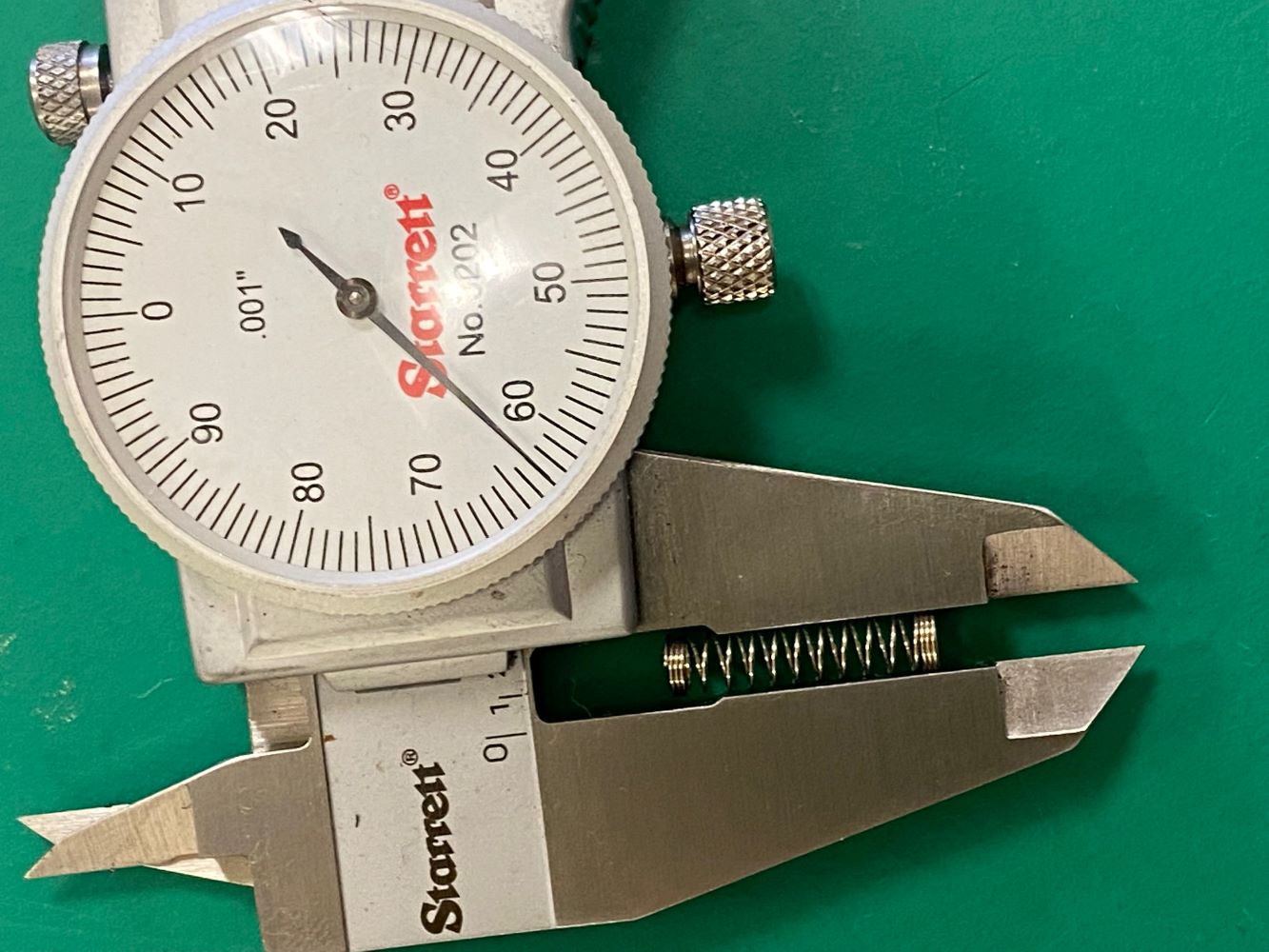

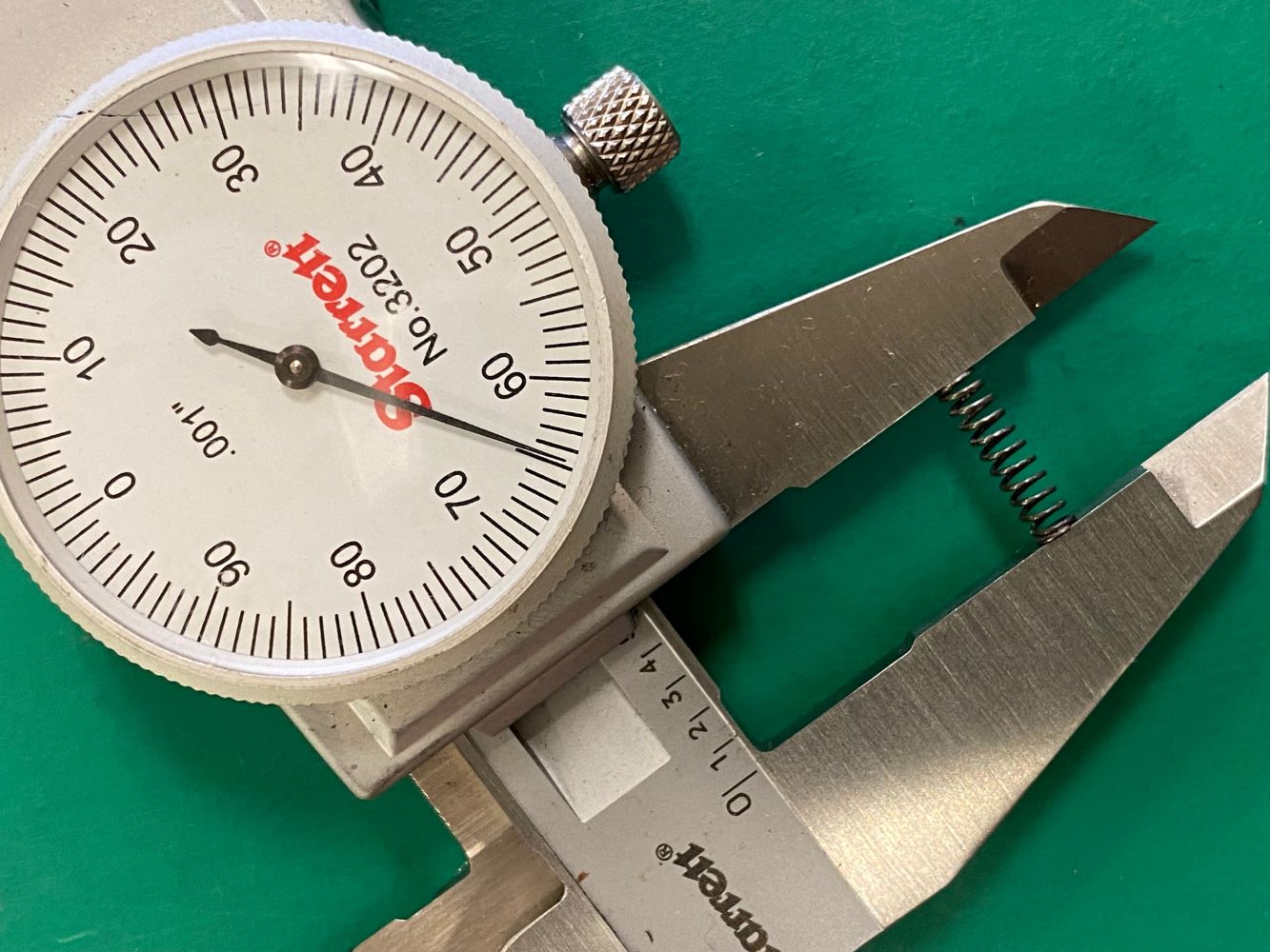

Re: Looking for trip spring
Merry Christmas Fox Fanatics!
.465" length - this is a new factory 12-gauge trip spring
.118" outside diameter(.120" dia will also fit into the trip pin counterbore and work fine.) The counterbore is a blind hole in the lower end of the trip pin that keeps the spring centered.
.016" wire diameter
Common ball point pen spring at .163" O.D. is too large to fit into the trip pin counterbore. I know fellas will try to use them but the spring can't properly push against the trip pin and sooner or later the pin or rotary bolt engagement surface(s) will get worn.
.016" wire diameter
