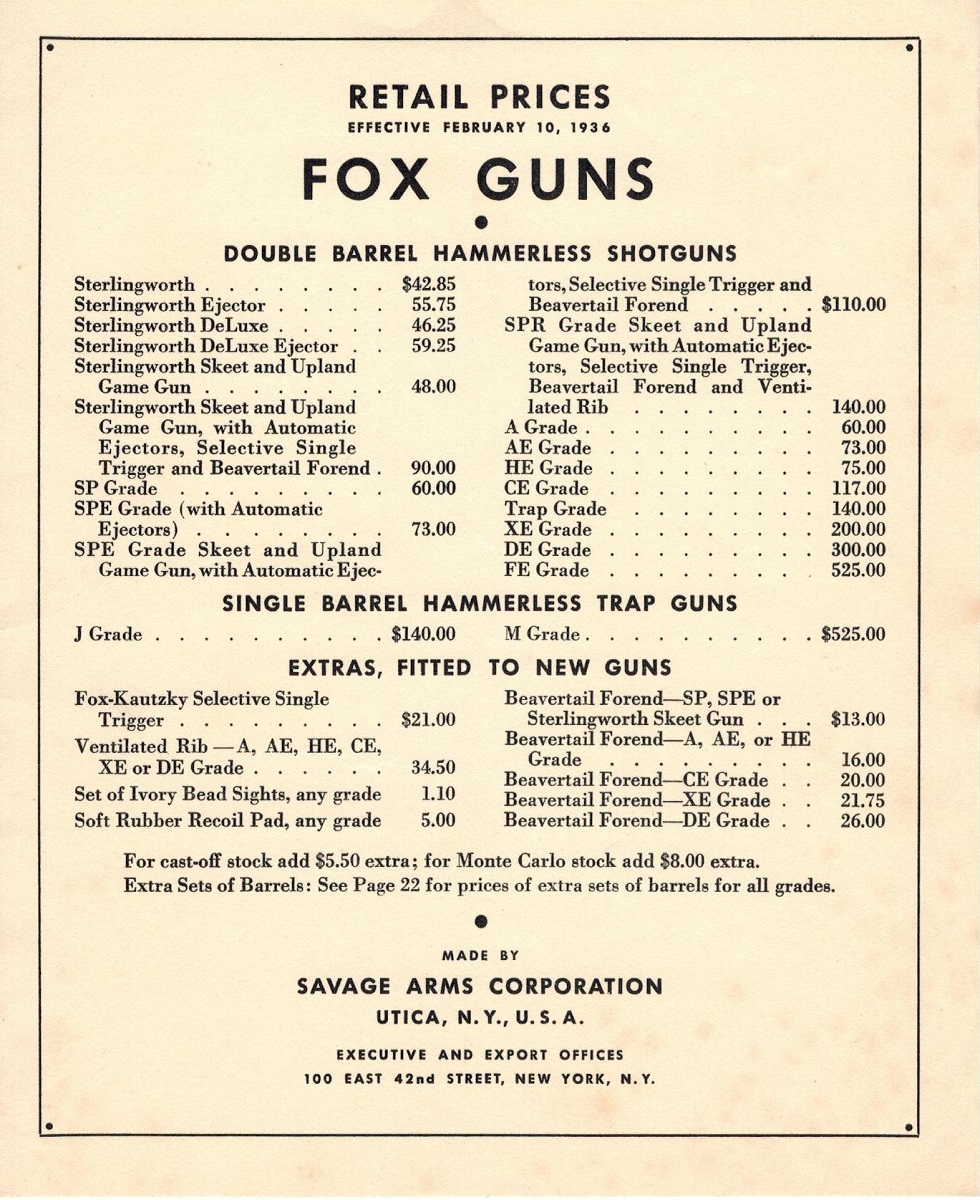

with the smaller beavertail forearm and a checkered butt. The SPR-Grade Skeet & Upland Game Gun only appeared on the 1936 retail price list --
