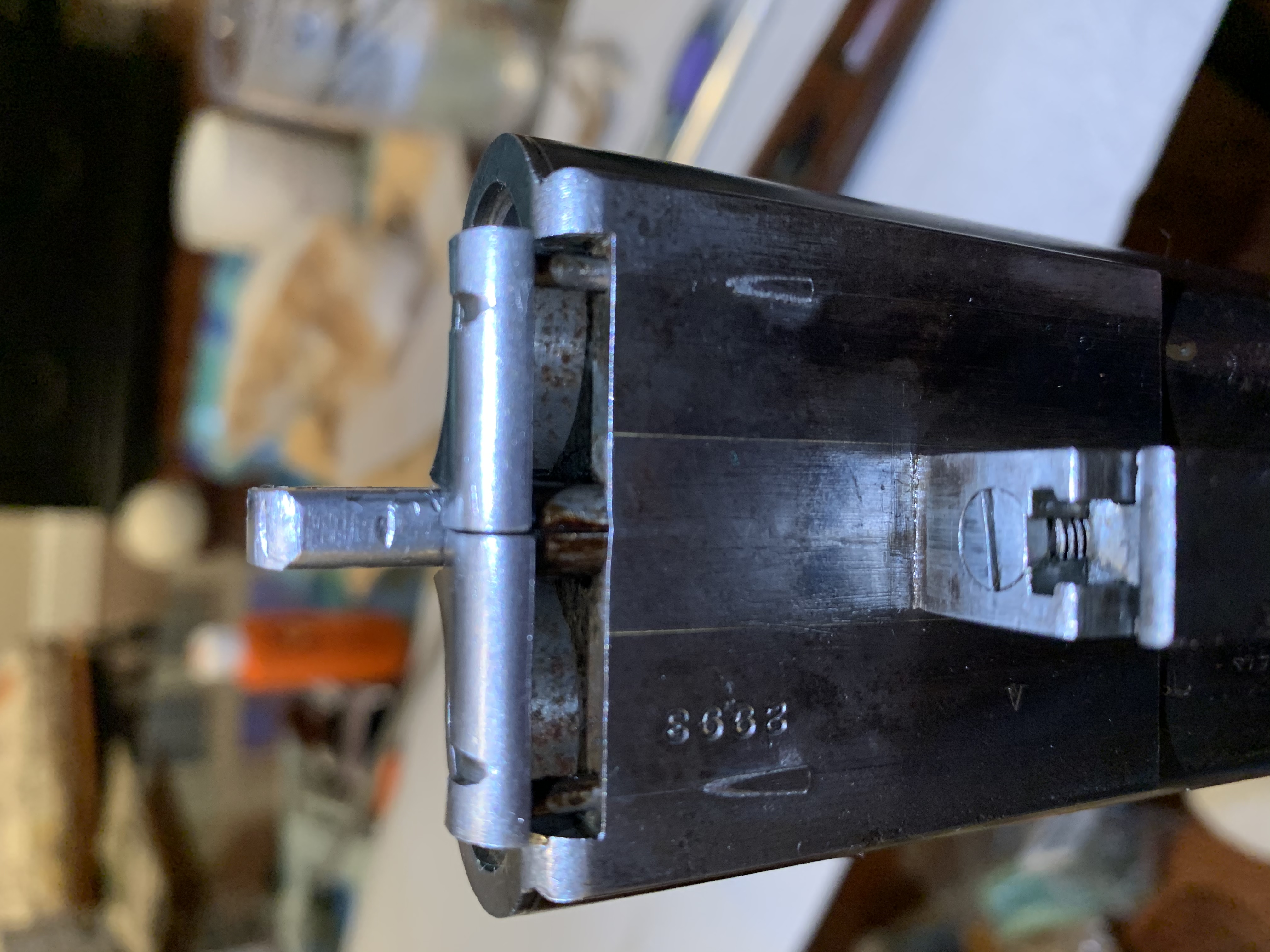

Re: Early Fox 12 gauge identification
Your gun may have been returned for ejectors after it was shipped. A picture of the front of the action where the forend metal intersects would tell us what style ejectors are fitted to your gun. It appears your gun was hunted in salt water as the action is covered with pitting representative of use in a salt environment. Its a AH Fox for sure, no card is available.
I will send three more as well. The gun came from an estate sale from NJ, you may be right about the salt !

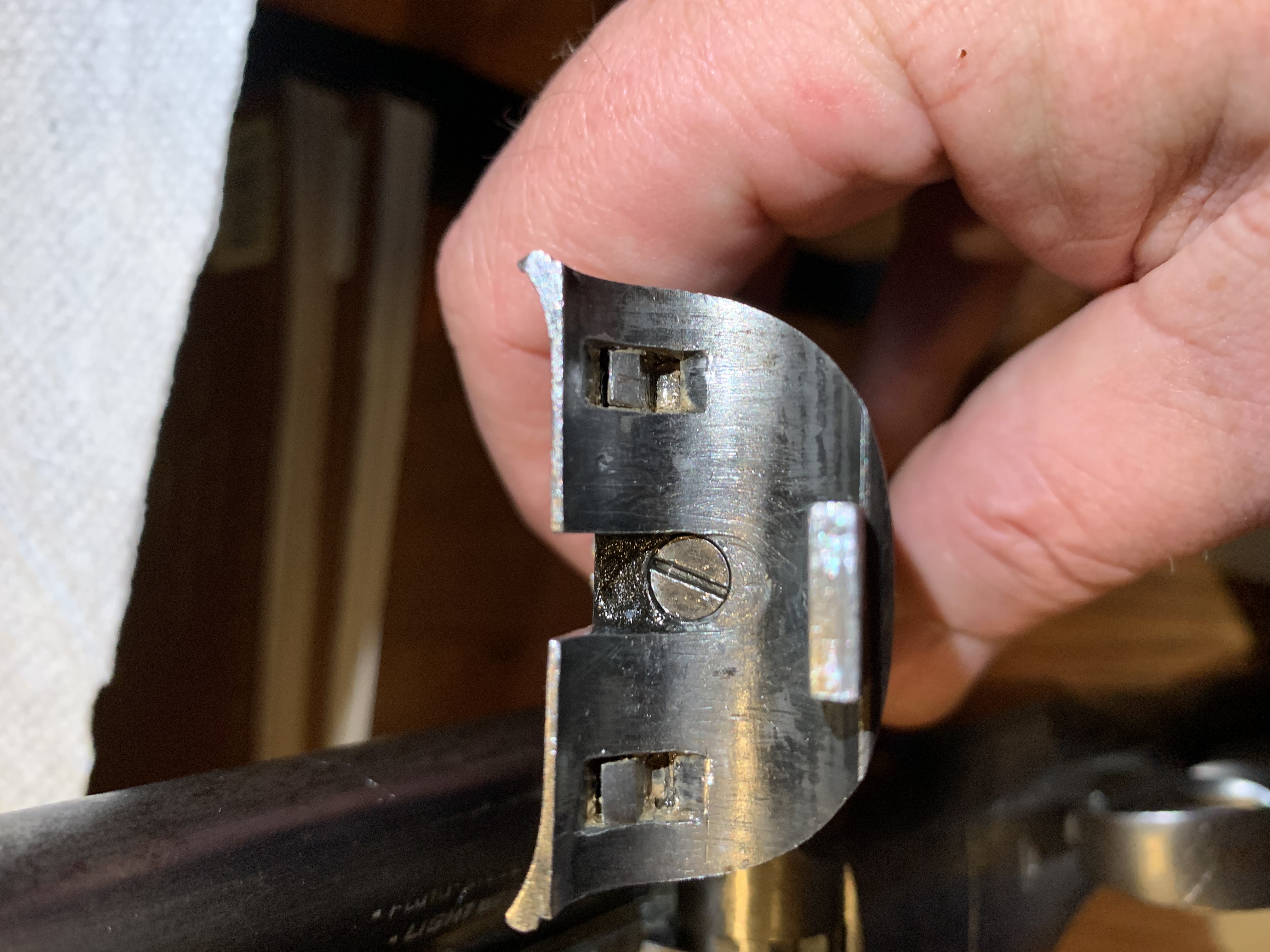

This is the front on photo of the forend, not sure if this helps.

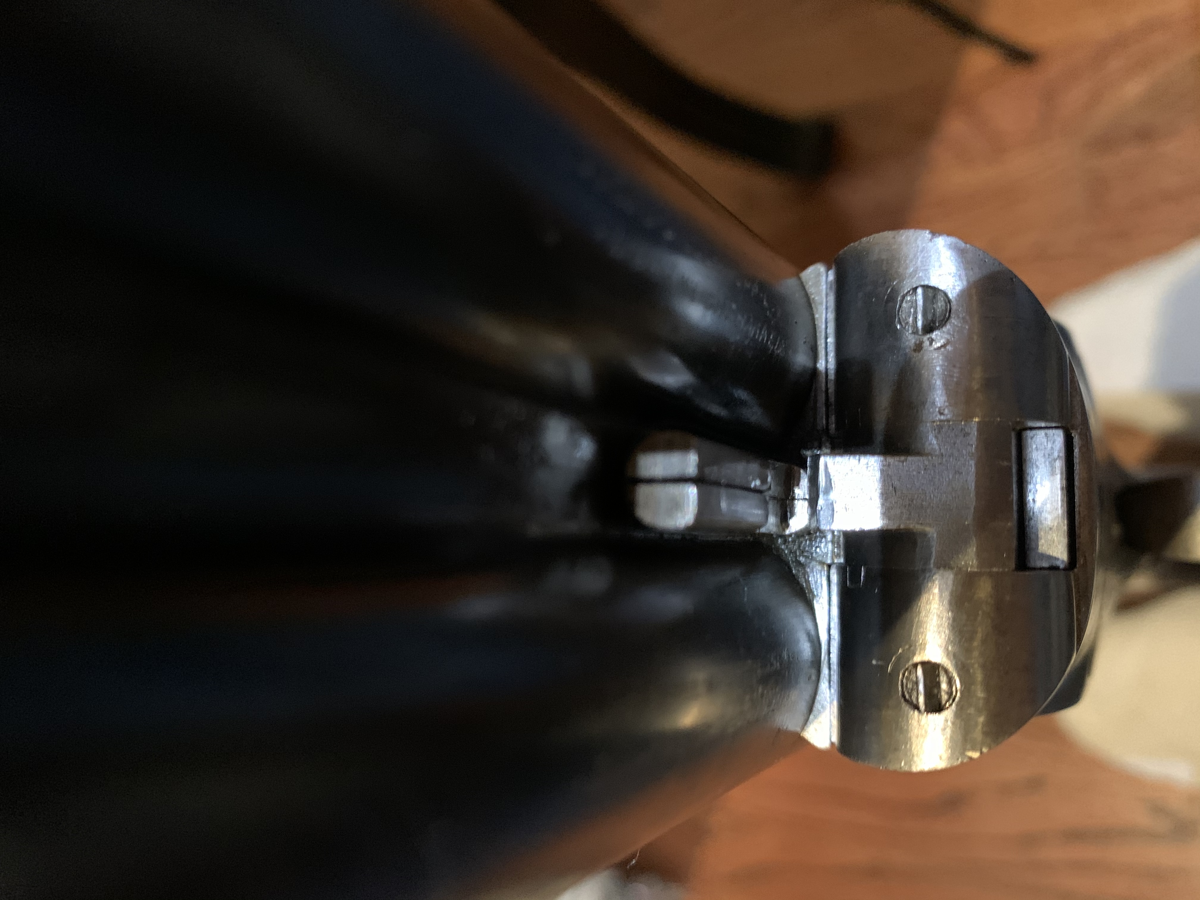

No action side picture, no the pitting it can't be fixed without a huge expense.
Birddog17!
- Posts: 28
- Joined: Sat Mar 27, 2021 5:21 pm
Birddog17!
- Posts: 28
- Posts: 4161
- Has thanked: 776 times
- Been thanked: 2165 times
You have a second generation ejector system, meaning your gun went back to Fox after 1913 to be fitted.
Thank you for this information. Was it typical for these guns to go back for a refit of sorts ?

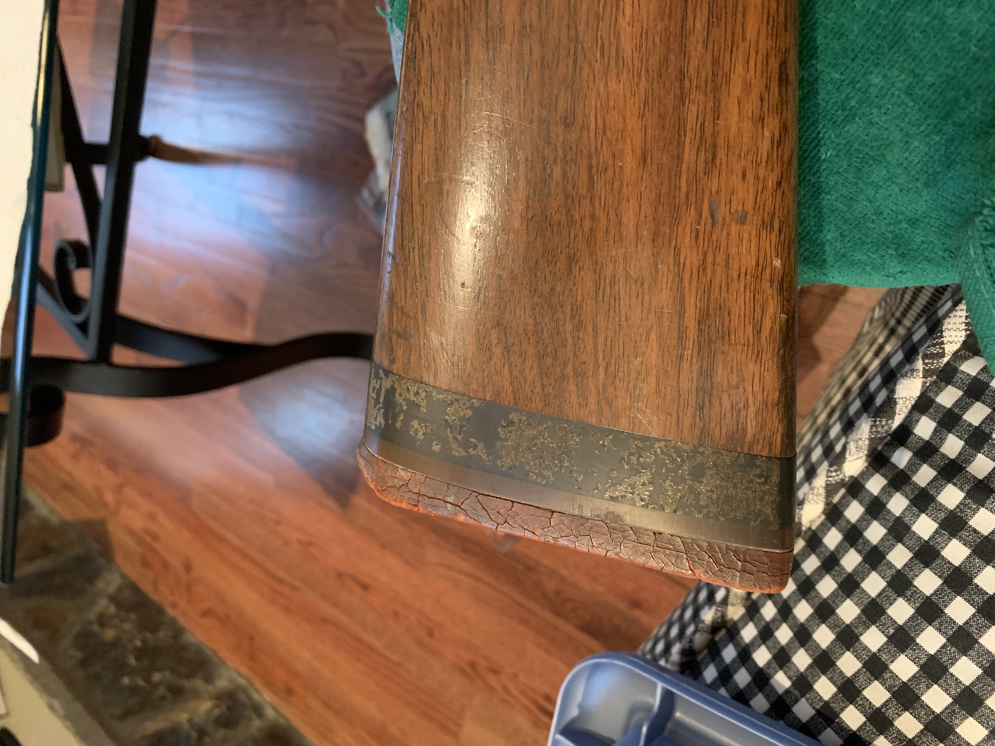

Some Foxes were sent for conversion from extractor to ejector, or from first to second gen ejectors but I wouldn't say either was typical. The steel used in these early Foxes was ordinary low carbon. The low serial number isn't that big a deal. OK so you have an early AE Fox that looks honest but only in fair condition from what we can see in the pics, and we haven't heard anything about the bores, firing mechanism or ejector function. The barrels might be bottomed out on the frame bar (what looks like bump marks in your last pic). That generally indicates heavy use. What does the buttstock look like, has it been cut short?
Just my opinion but I think your Fox isn't a candidate to spend a ton of money on. Assuming she checks out for function and safety-wise I'd say just enjoy her as is, as an example of a Fox that served her owner(s) in the days when family food came from the grocery as well as the game fields and waters.

Hi Frank,
Thank you for all of this information. Yes I paid for. Three year membership using PayPal. I ha e caught the bug. I will send you a Stock photo and Butt plate.
