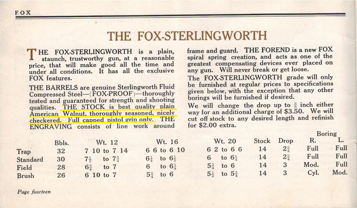

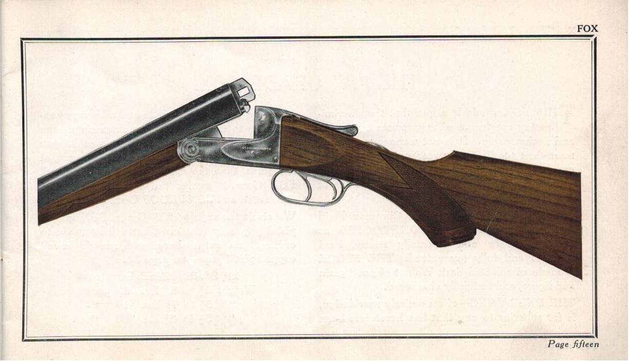

Sterlingworth is the grade. The Sterlingworth was the A.H. Fox Gun Co.'s entry-level gun, made for stock and to standard specifications. From the A.H. Fox Gun Co.'s founding in 1905, the graded guns A- to FE-Grade were stocked to your dimensions in European Walnut, with the choice of straight, half-pistol or full pistol grip and had Krupp Fluid Steel barrels. When the Sterlingworth was added to the line in 1910, some of the money-saving features were that it was stocked to standard dimensions in American Walnut with a capped full pistol grip only and barreled with tubes the company called Sterlingworth Fluid Compressed Steel. With a serial number in the 114xxx range your gun is likely from the late 1920s. Here are the Sterlingworth pages from the 1927 A.H. Fox Gun Co. catalog --
