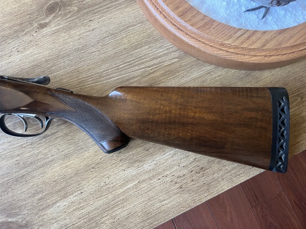

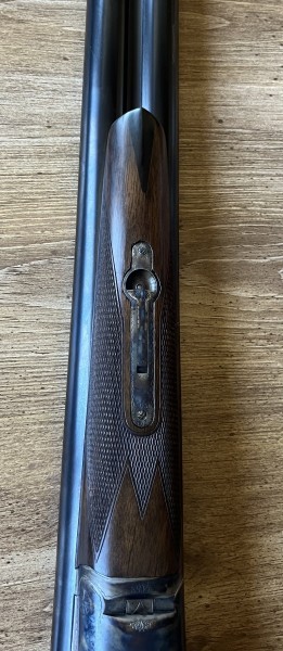

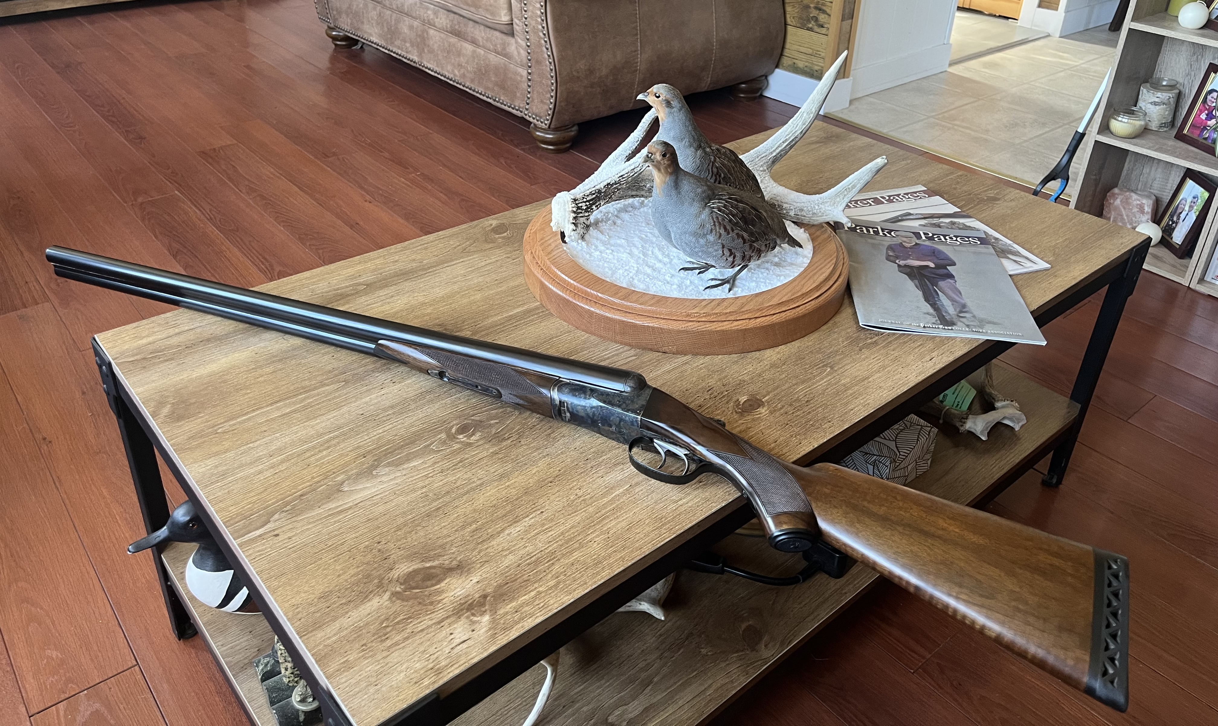

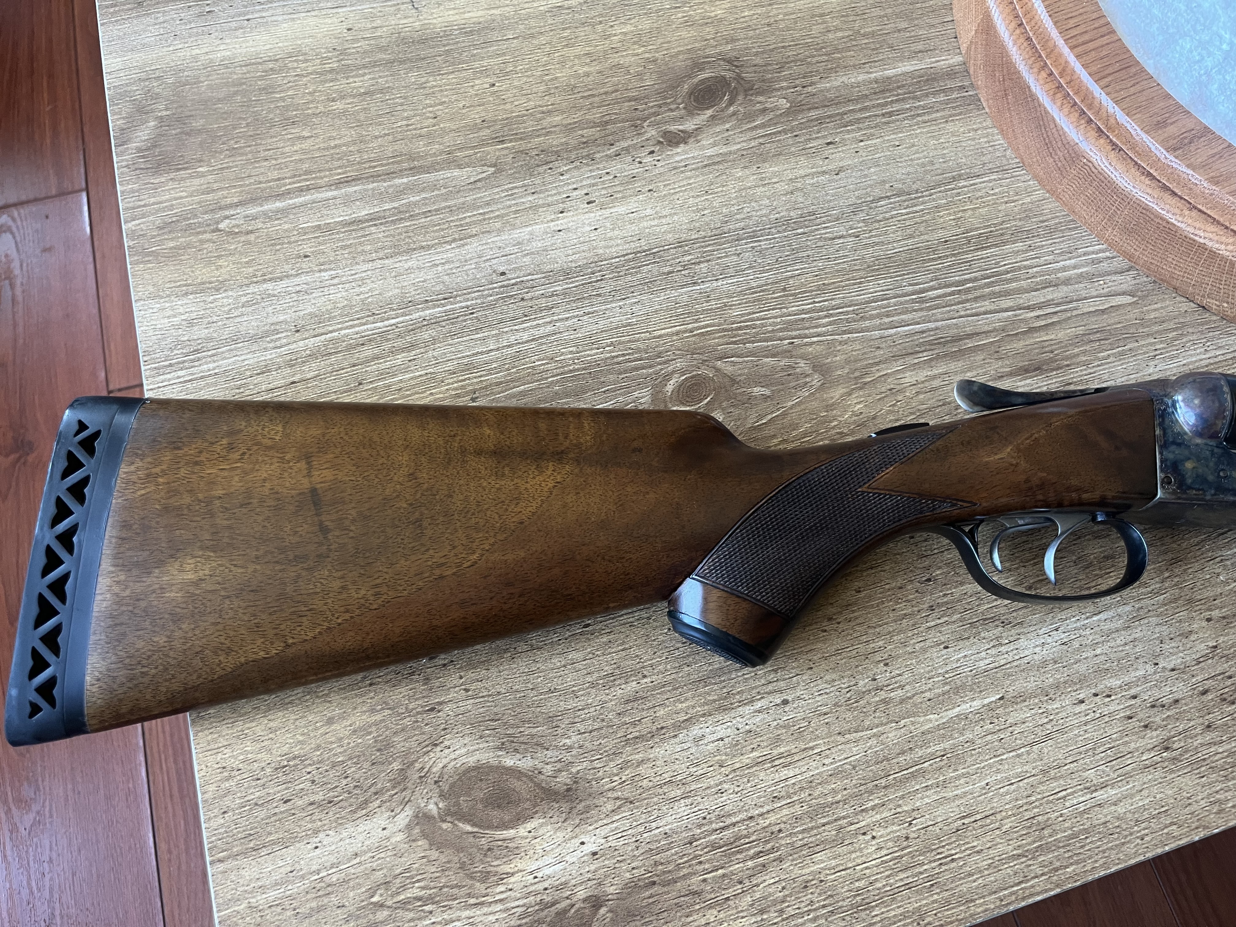

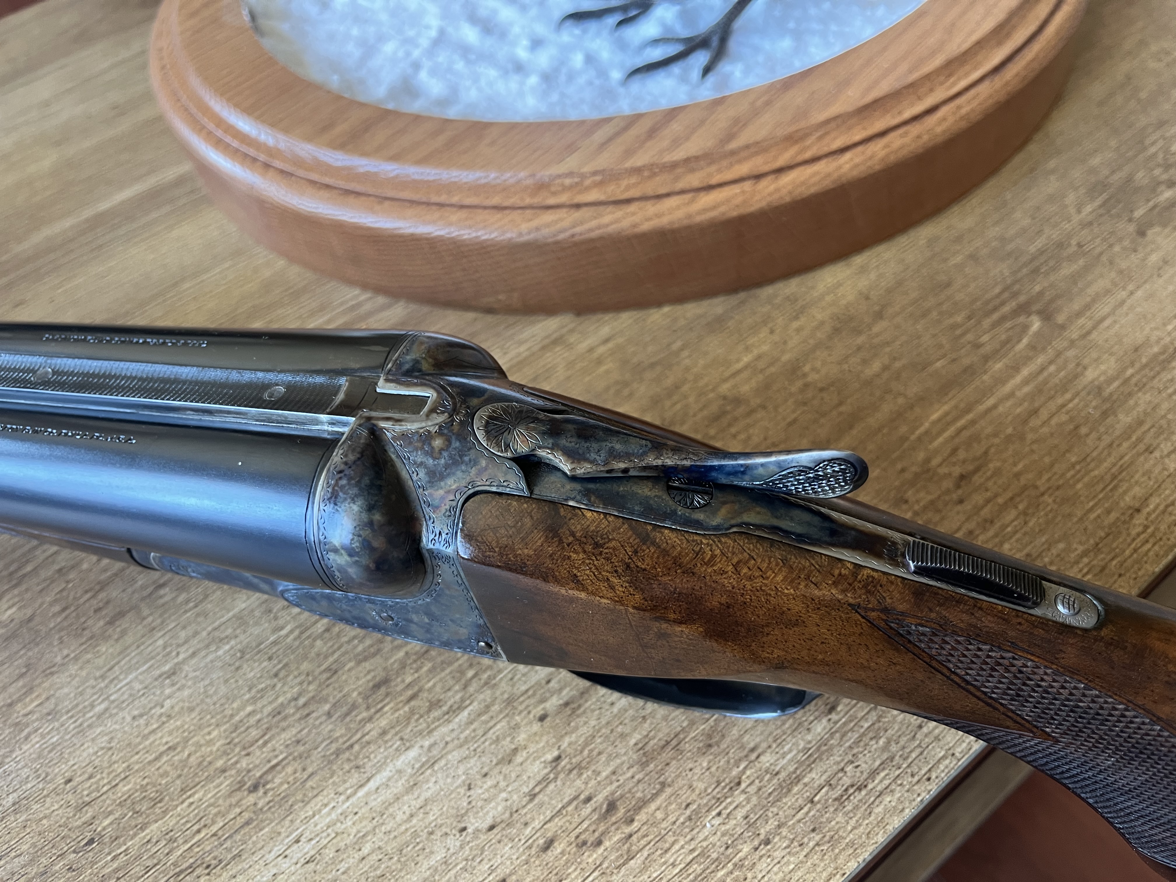

My Superfox made it home from restoration with plenty of waterfowl season left ahead. I'm headed back to Fort Mac for my final rotation at 2026 Horizon Oil Sands turnaround tomorrow so the old girl won't make it to the blind before Oct 1st but as soon as I'm home I'll be scouting out a hunt and putting the old girl to work by Oct 2nd!
Here is a few pics until I can post some from the field but still looking pretty sweet! Even the old Hawkins pad cleaned up nicely and almost looks new!

You certainly have enough fowl to exercise that beauty. Thanks for sharing.

Your gun looks great. I’m envisioning a picture of many dead mallards in your future. Enjoy it!

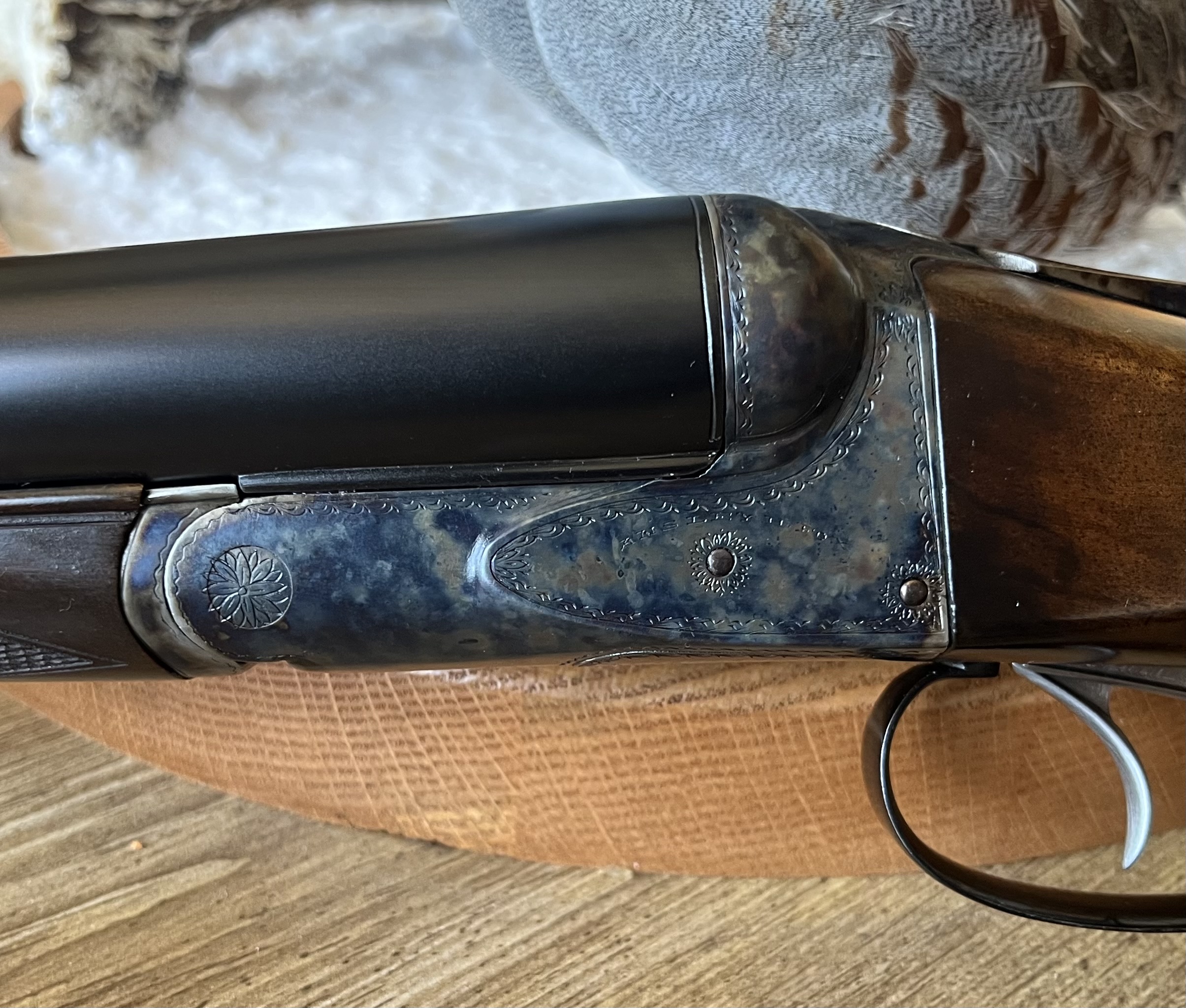

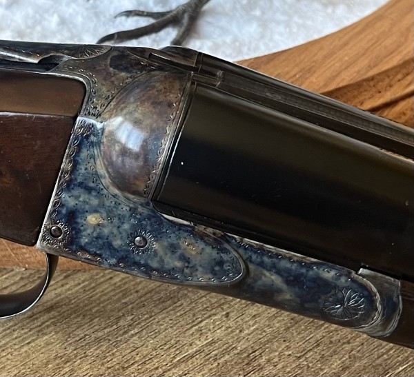

Gun looks great Frank! What work was done to it and who did the work for you? You’ll have fun with that one!!
Re: Super Fox Is Home
Restorations: Gunsmith's name left out at their request.
1: New CCH of receiver, top lever & forend iron.
2: Reblue barrels & trigger guard.
3: Refit floor plate and re-engrave floor plate and floor plate screw.
4: Refinish stock with hand rubbed oil finish, recut checkering and freshen up(original?) Hawkins recoil pad.
5: Manufacture, finish and checker new forend.
6: Put barrels back on face.
7: Measure bores and record choke constrictions.
Added info:
The specs have changed considerably. This gun had a bit of a tough life to judge by some of the bubba gunsmithing it appears to have received by a previous owner(s). A Cody letter shows it started life as a first year production 1923 HE Grade sporting 30" bbls, 2 3/4" chambers & choked M/F. The Fox card does not show the choking ordered so how Cody determined the chokes I do not know? A previous owner also drilled two holes in the rib just ahead of the fences about 3" apart for what I can only assume was some kind of aftermarket sighting device. Those holes were filled in as best as possible but they are there and noticeable.
The Fox factory card also does not record the gun started life with a single trigger but the gunsmith discovered the original trigger that serial # matched to my gun in another gun through his networking with other gunsmiths in the trade. Someone replaced the single trigger with the doubles it wears now.
At some point a previous owner cut the barrels back to 28" and the gun retained an area of choke over a 2" long section in each barrel that now mic at left barrel .017 constriction and the right .019. I had no issue last fall killing ducks out to 40 yards with a 1oz load of #4 bismuth with a mv of 1200 fps and big Canadas to 35 yards. I patterned the gun with 3 dram 1 1/8 oz #7.5 Federal Top Gun ammo right after I purchased it and both barrels surprisingly produced full choke percentages. I haven't patterned it with my bismuth ammo as I have a very limited supply.
The gun still wears the original stock and possibly recoil pad. The pad is an old solid black colour Hawkins that the gunsmith freshened up to look almost brand new again.
The checkering lpi on the forend did not match the stock so one can only assume it was replaced at some point too so a new forend was made to match the stock.
There is not the collector value in the gun many enthusiastic collectors would be looking for but for a nice restored shooter it is a sweet gun and that is what I bought it for. It's time to take to the field with the newly lifed old girl and let her do what she was originally built to do, put game on the table!
Added info:

Thanks for taking the time to add the details. Sounds like a very thorough restoration and I’m sure you’ll have fun with it. Maybe you could do me one favor…. Miss a few mallards so they make it to Michigan for me.

Those appear to me to be cyanide case colors (could be wrong). Wasn't aware anyone was doing that anymore. PS. I think they look fantastic btw. Would love to know who did them. Perhaps a PM if you dont' want to put it on the forum.

Nice job to bring that Super back to respectability Frank!
I happen to like those Case Colors, not so gaudy as some restored guns you see out there.
