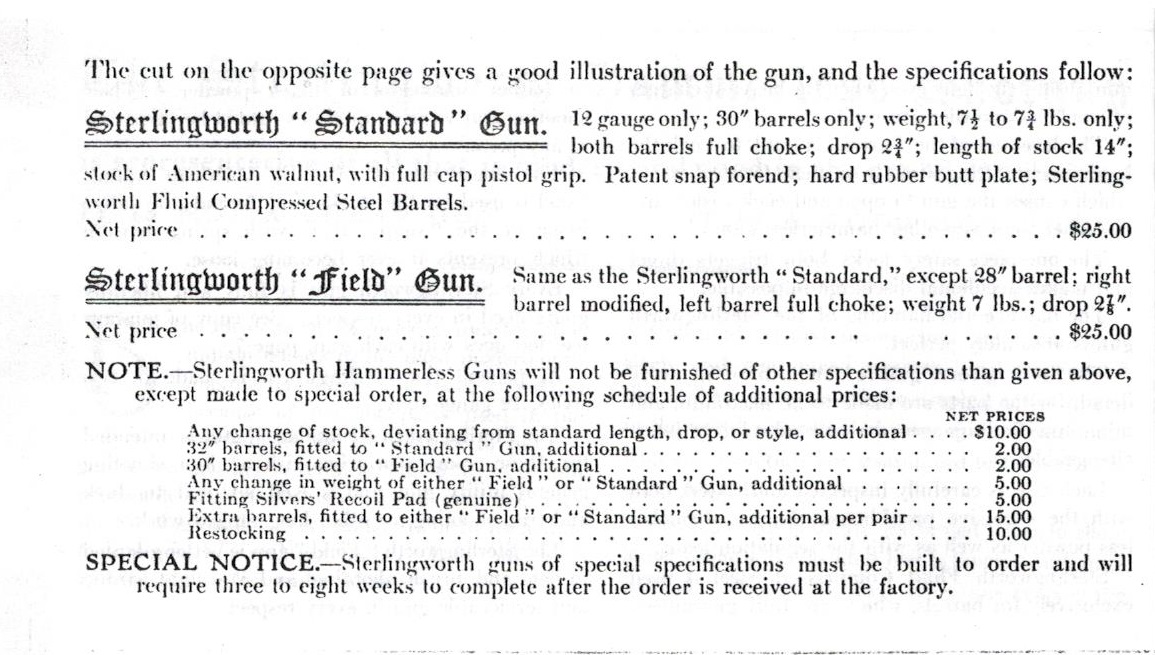

When the A.H. Fox Gun Co. added the lower priced gun, made to "standard" specifications, to their offerings for 1910, they marketed them under the name The Sterlingworth Co. They even issued a separate catalog for the guns --

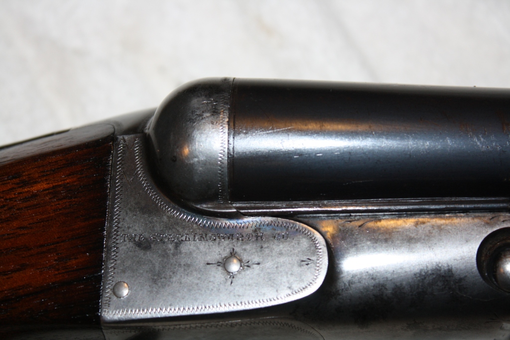

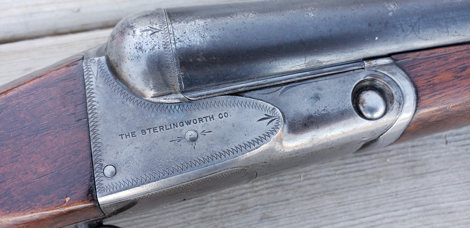

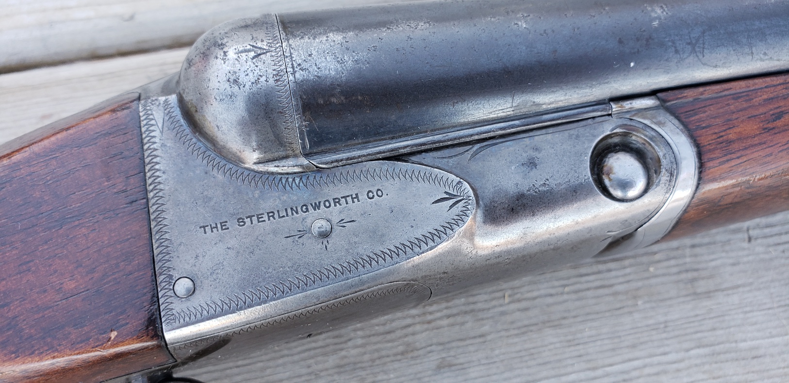

The Serial numbers for these 12-gauge, The Sterlingworth Co. guns began at 50000. From my years of recording observed guns, the earliest guns have a rounded profile to the sides of the frames --

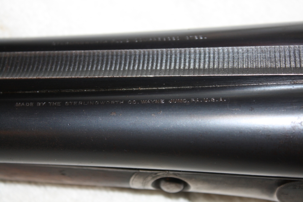

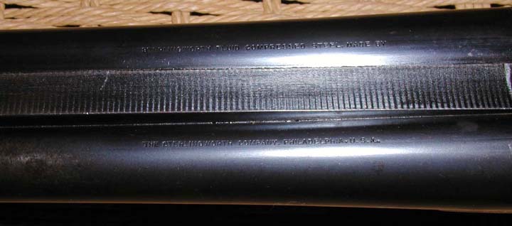

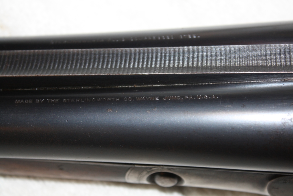

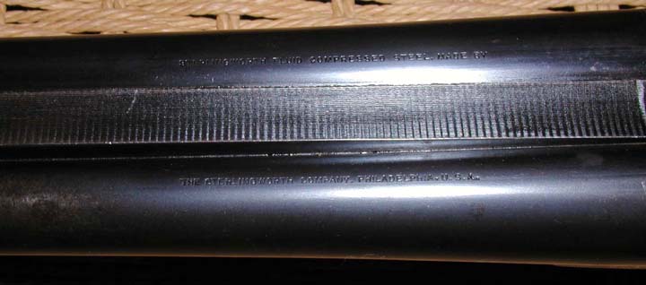

and about the first 200 have Wayne Junc. as the address, but after that Philadelphia, U.S.A.

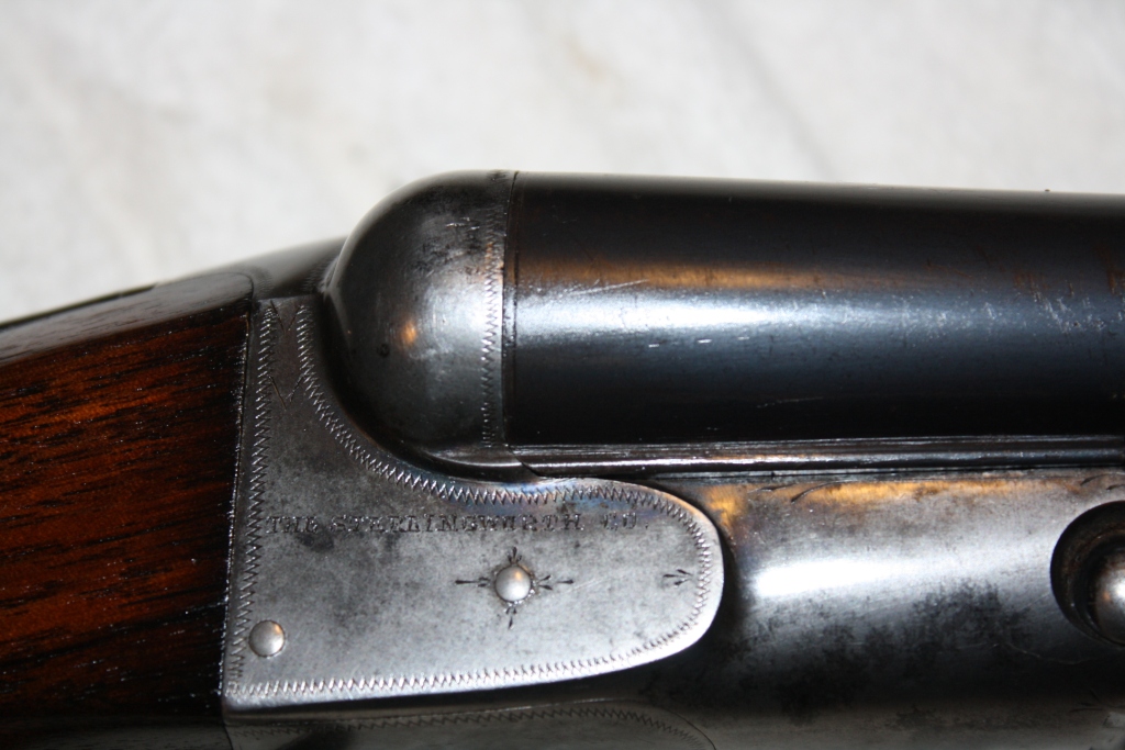

In the range from 502xx to 505xx the profile of the sides of the frames transitions to the more pointed "Fox" profile --

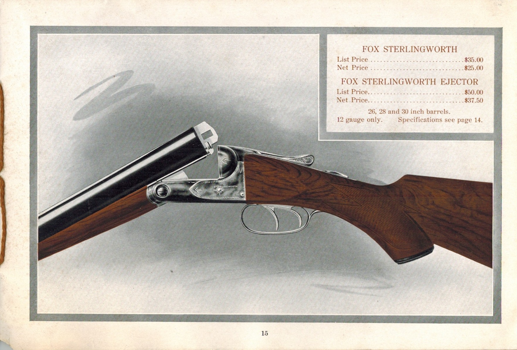

The "The Sterlingworth Co." idea apparently wasn't working and the Sterlingworth is included in the 1911 A.H. Fox Gun Co. "Campfire" catalog and the guns are marked on the forearm iron MODEL 1911 --
The transition occurred in the 53xxx range. The first MODEL 1911 I've recorded is 53140 and the last The Sterlingworth Co. gun I've recorded is 53824.
