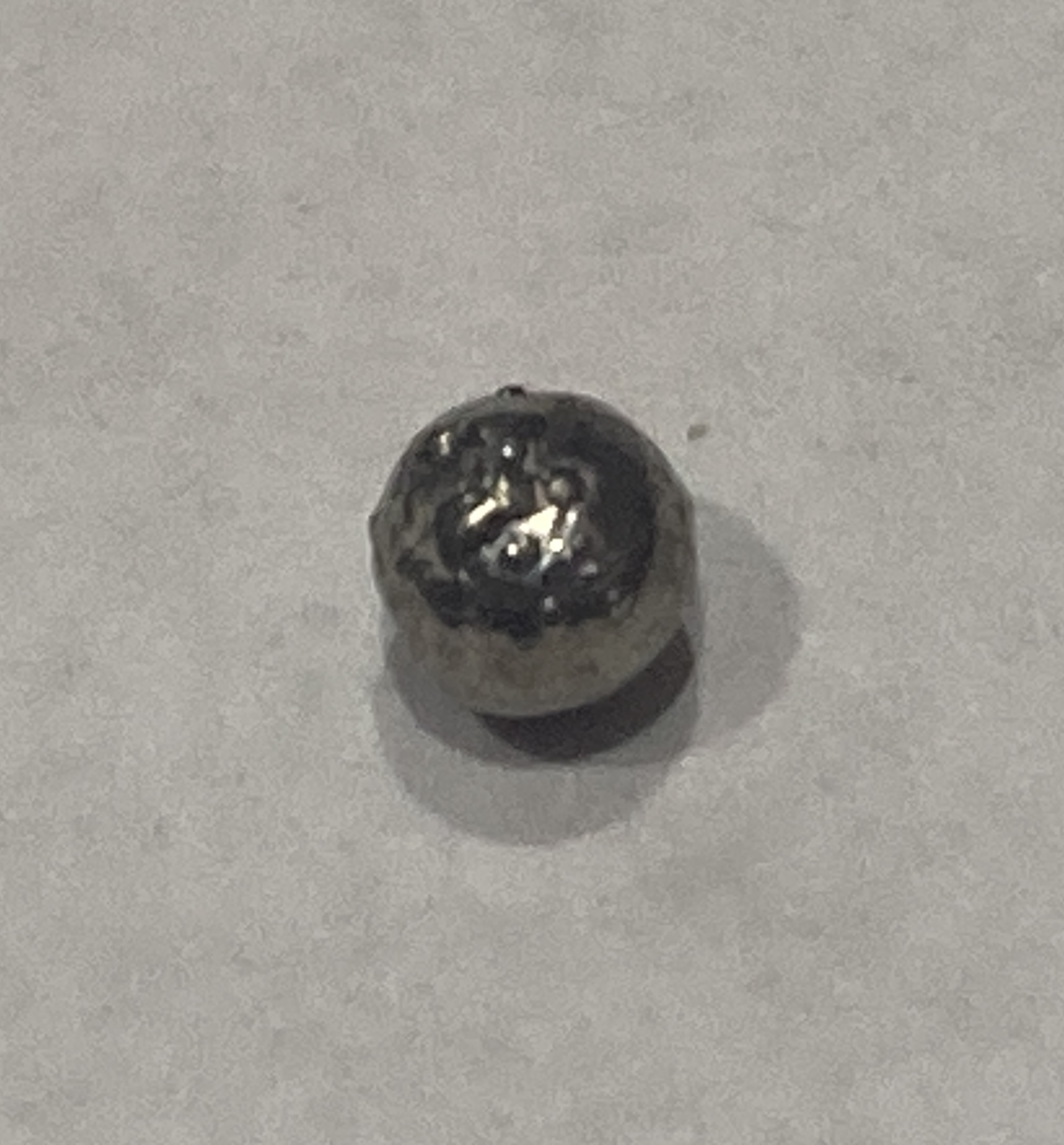

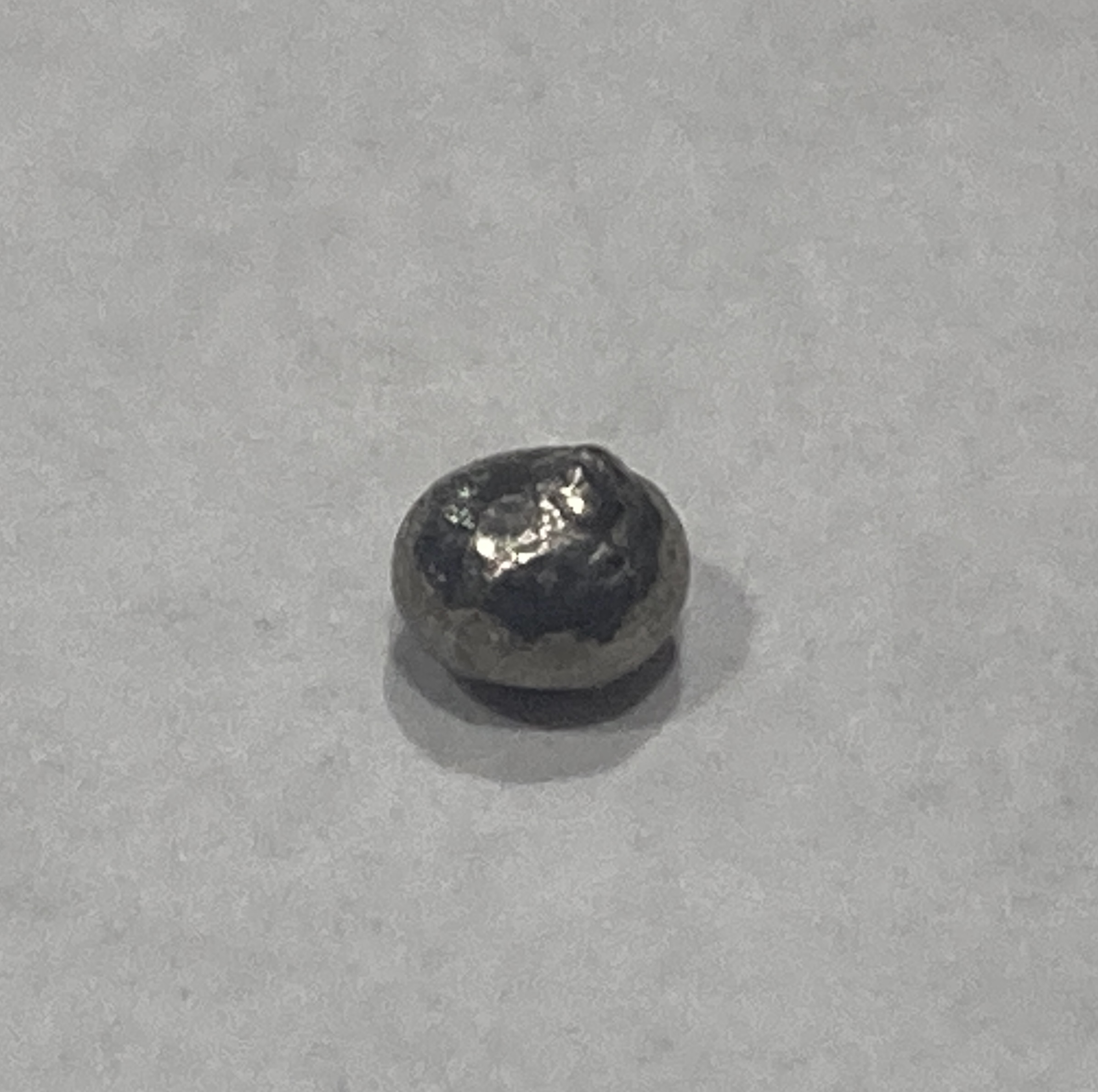

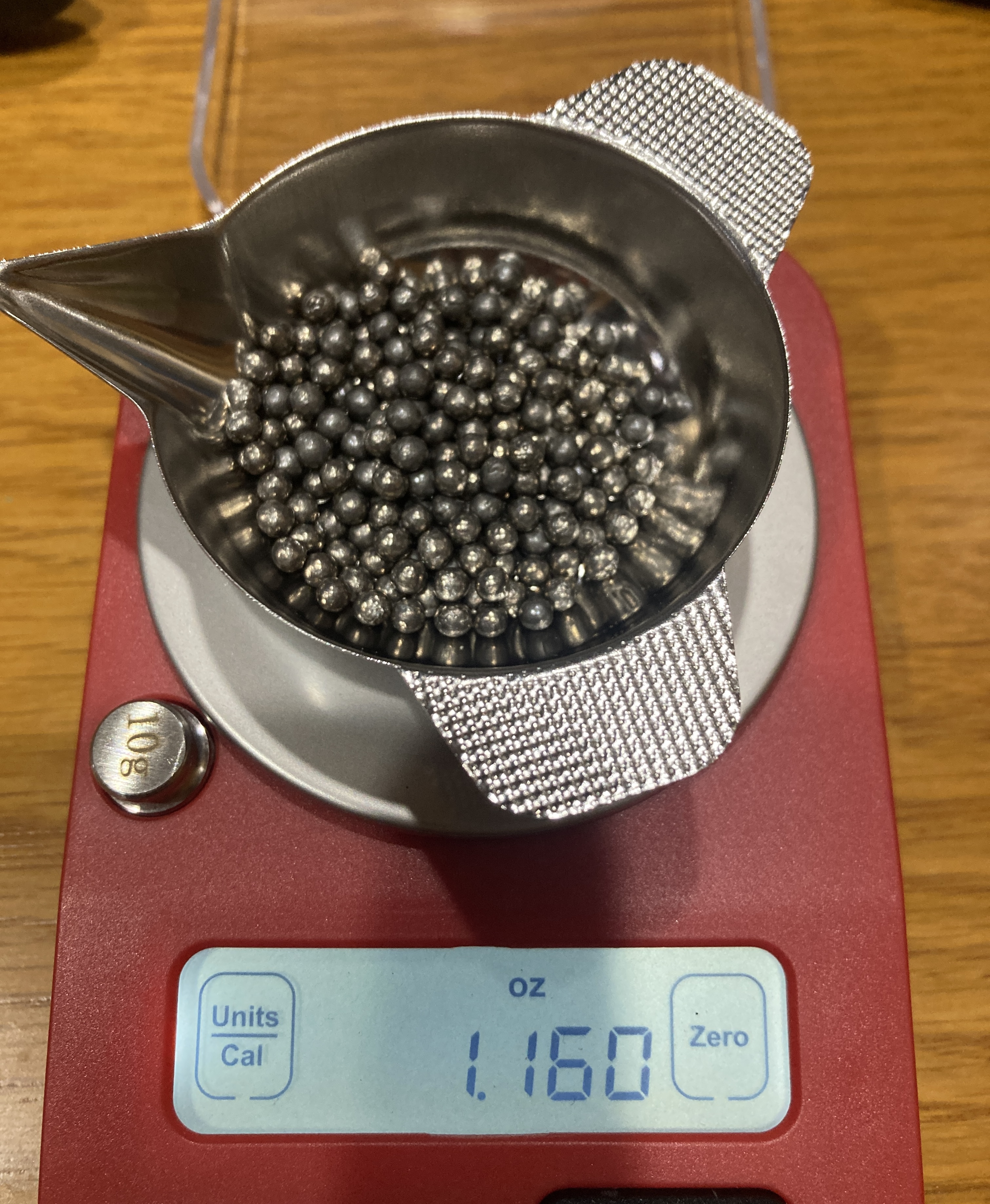

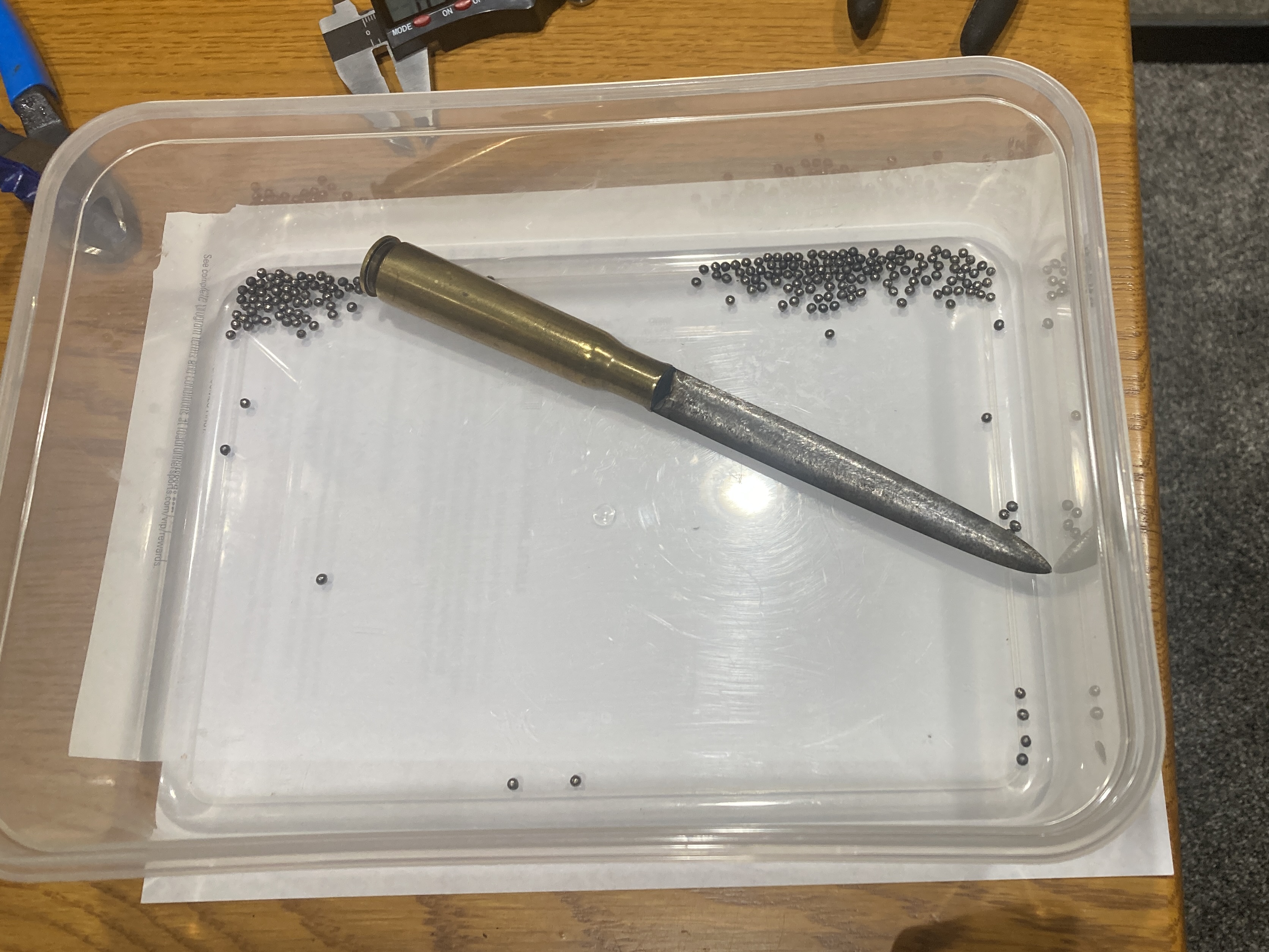

No problem. I have cut open bismuth loads before and have been dismayed with the shape of the pellet. I’m not familiar with manufacturing process, but every pellet is somewhat oval and loaded with imperfections.

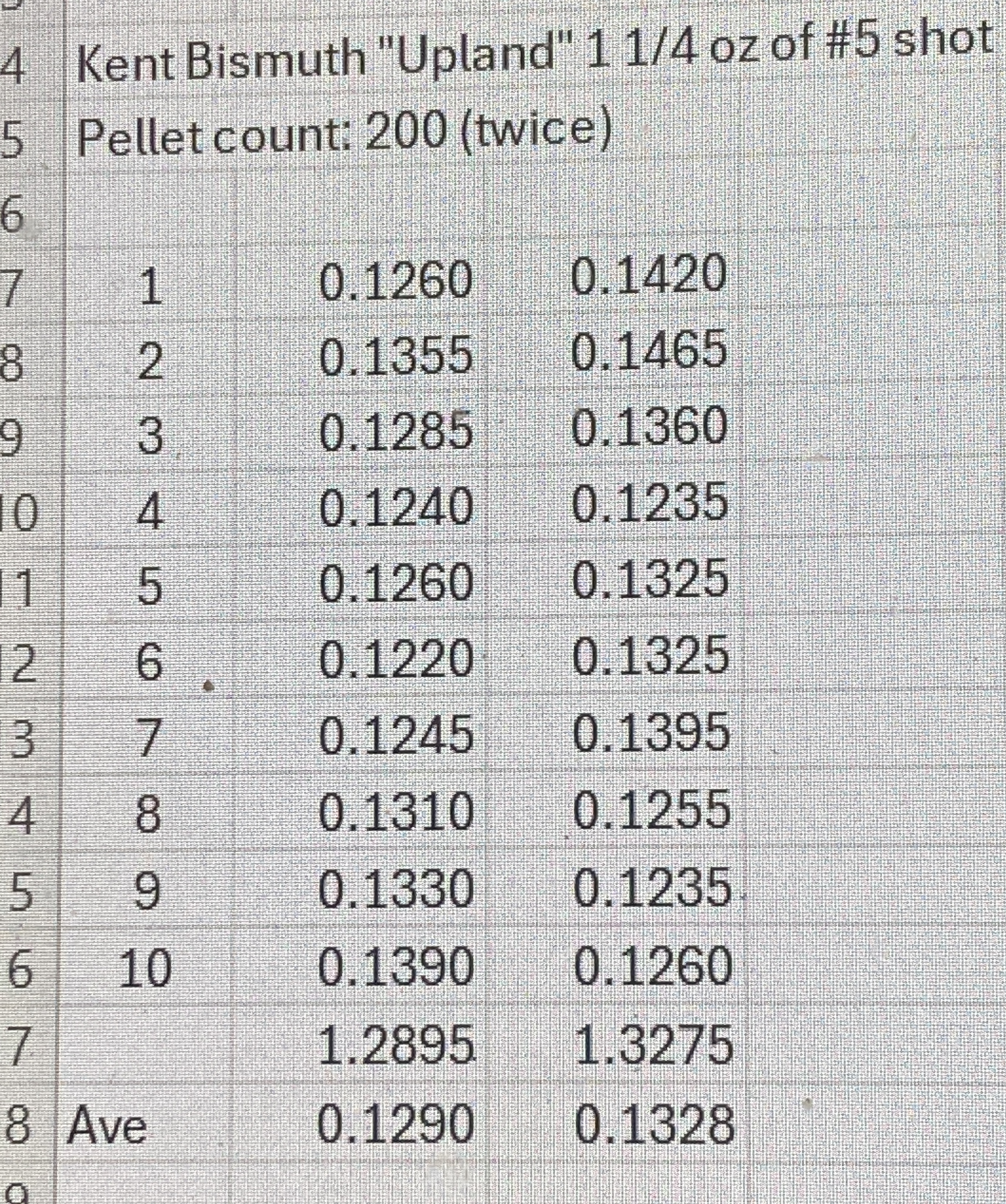

First, I counted the pellets, twice, and arrived at 200 both times.

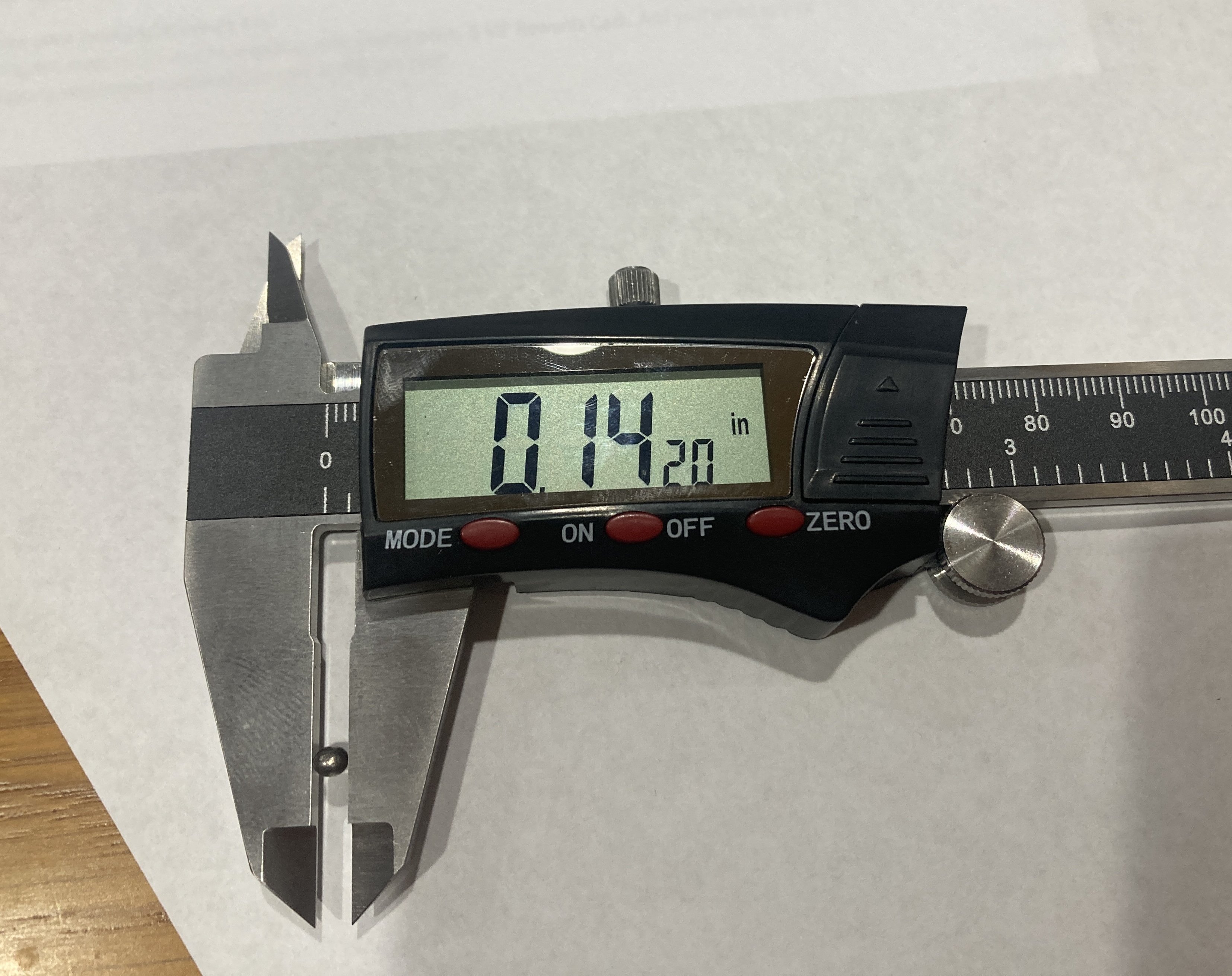

Second, I measured 10 pellets, taking two measurements on each pellet. On each pellet, I took a measurement, then attempted to rotate the pellet, and record a second measurement. The first measurement on the 10 pellets averaged .1290”. The second measurement on the 10 pellets averaged .1328”.
Lastly, I confirmed that the pellets are encapsulated in a cup as they travel through the barrel.
As for the sandwich, please deduct it from the dozen sandwiches that I owe you.

Ha Ha Ha! I always enjoy hearing from you Roger. By the way…. My new 28” XE is named Bettie. Can you guess who it’s named after?

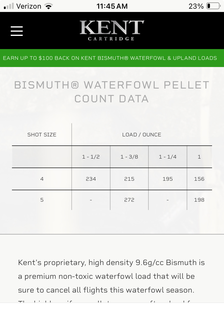

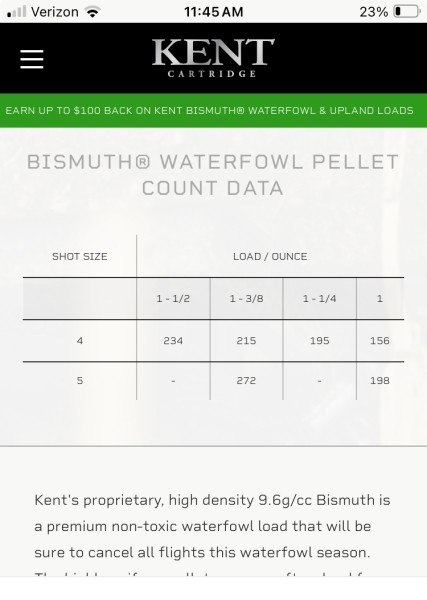

Now, back to the ammo. Please remember that my 1 1/4 oz. shell contained 200 pellets. Their sheet says that there are 198 pellets in a 1 oz. load. Also, for what it’s worth, those 200 pellets did not weigh 1 1/4 oz. Darn shrink-flation. I guess we should load our own ammo.
Posts: 2826
Re: How do you warm up for bird season?
All very good info, Jeff. That's the kind of stuff i can get my teeth into.
