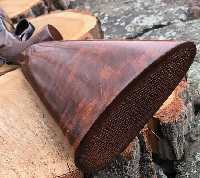

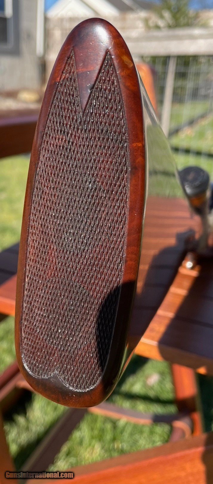

I'm definitely still wondering if how the butt is simply checkered is odd ?
Posts: 2316
Has thanked: 1513 times
Re: The XE came home with me today
Paul, curious when you shot it if both barrels were hitting where aimed or if “Point of Impact and regulation” was affected given the length of barrels that was cut off. Hopefully it won’t impact it. To answer your second question about the checkered butt. Fox like many manufacturers would do a checkered butt upon request….especially during the Savage era. It was somewhat common for purpose built skeet guns to have a checkered butt during that time period. If someone had the stock made later than they could have any butt configuration they wanted. Many SPE Skeet & Upland guns were built w/checkered butts. Given someone shortened the barrels, had a beavertail FE made for it and a straight stock they could have very well been purposefully turning the gun into a skeet gun to satisfy their desires. Wouldn’t we all love to go back in time and listen to the conversations that led to the “customizing” of these guns! Brett

The bare wood checkered butt was quite often a feature U.S. double gun manufacturers put on skeet guns.
