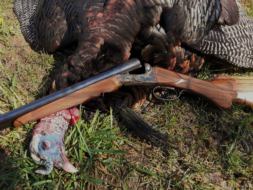

Posts: 3597
Has thanked: 1028 times
Been thanked: 1472 times
Re: Spring Turkey Loads for my Superfox
I have a stash of RST Pigeon loads in size 6. They have taken more then a few Tom's over the years. They are 1 1/4 oz. If you have some give them a try on the pattern board. Above said, I think the longest shot I've taken with my Fox and that load is 20 yards. Get them close enough and most anything will work. I aim for the neck where it meets the body. PS. This is the Abbygun in the pic.
