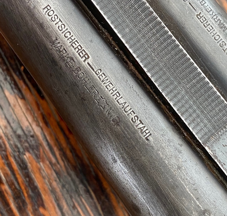

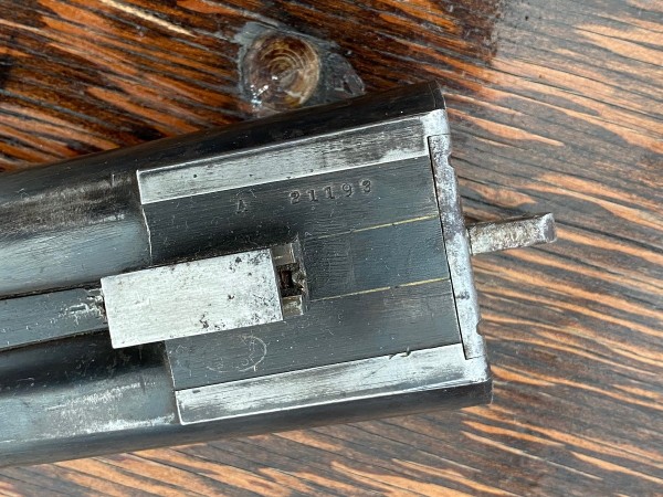

Several of us looked at the 34" A Grade today, and with the owner's permission I took some extensive macro pics. It has some hunting wear but is basically honest. I’ll post some pics when I have more time; tough posting anything while involved in an event and busy afterwards. The gun points like a dream to this guy. Barrels have no weight stamps but aren't that heavy. Most interesting to me is that the barrel legends in German read rustproof steel (English translation) and "Bohler", also is stamped “Made in Austria” in English on the long reinforced forend lug, but it has a regular Phila Fox Proof/oval mark and is absent a plethora of the typical Euro water table and lower barrel breech stamps. Seems to me that Fox assembled the barrels using imported Bohler tubes, but why not put the Bohler markings on the bottom as Fox did with Krupp steel markings? Incidentally on close inspection the word Bohler as written here actually has the German umlaut above the “o”.

Here I want to report on my tech inspection of the 34" Fox serial # 21193.

For those interested, specs on the 34" barrels are: bores REALLY tight at .715/717", chokes 28 and 30 points (3/4 choke in vintage parlance), choke length about 4-1/2" full tapered, and 2-7/8" chambers. Although this gun shows hunting wear, all considered I'd bet she was originally ordered as a Live Bird gun. Those 34" tubes are light and lively! Regarding the tight bores, these are the smallest 12-gauge I recall measuring on an American SxS and that reminded me of something I heard years ago from an older and very good live bird shooter, how many into that sport liked tight bores for a longer shot string. Yeah I know that's contrary to the hype on short shot string with overbored barrels. etc.
