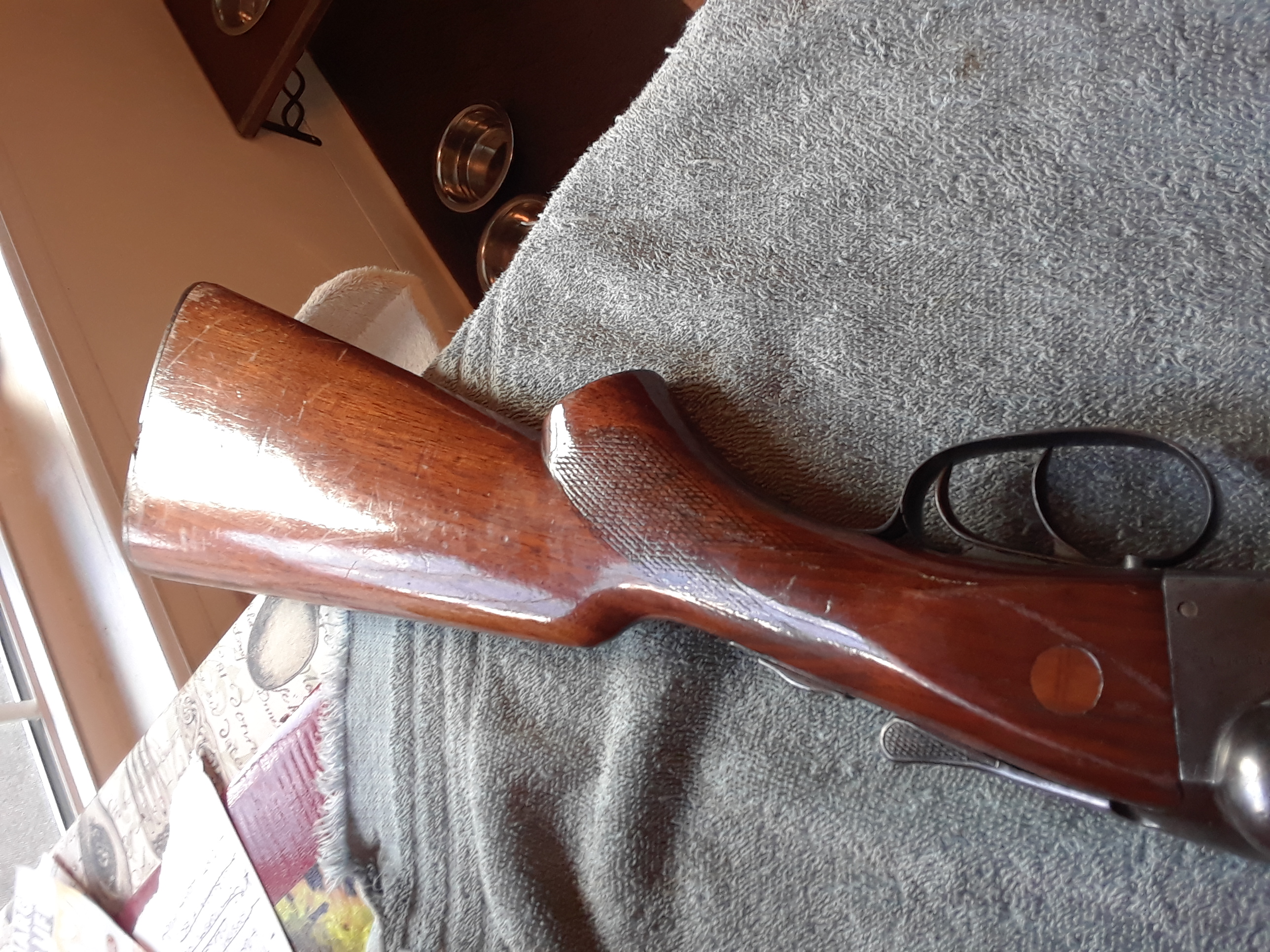

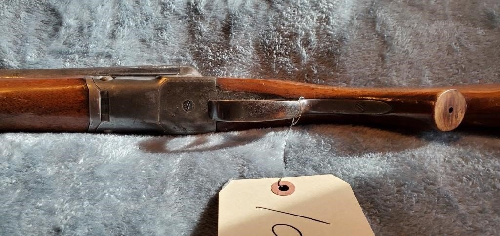

I picked up an old Sterlingworth 12 gauge at a family auction recently. It was just a decoration on their mantle I guess. The serial number is 50040 on all the parts, and from what I have gleaned from the internet so far, it seems to be one of the earliest that came off the line starting with the 50000 numbers. I has a bad rib separating that needs repaired. Hoping that a basic gunsmith can handle it. My shotgun experience is limited to a Mossberg 500, so I'm not knowledgeable on these old guns. I haven't had much time to really get into it and research it yet since it needs the repair first. The barrels are very long (32"?) and in good shape. I'll have to get some more pics of the numbers and such on the barrels.

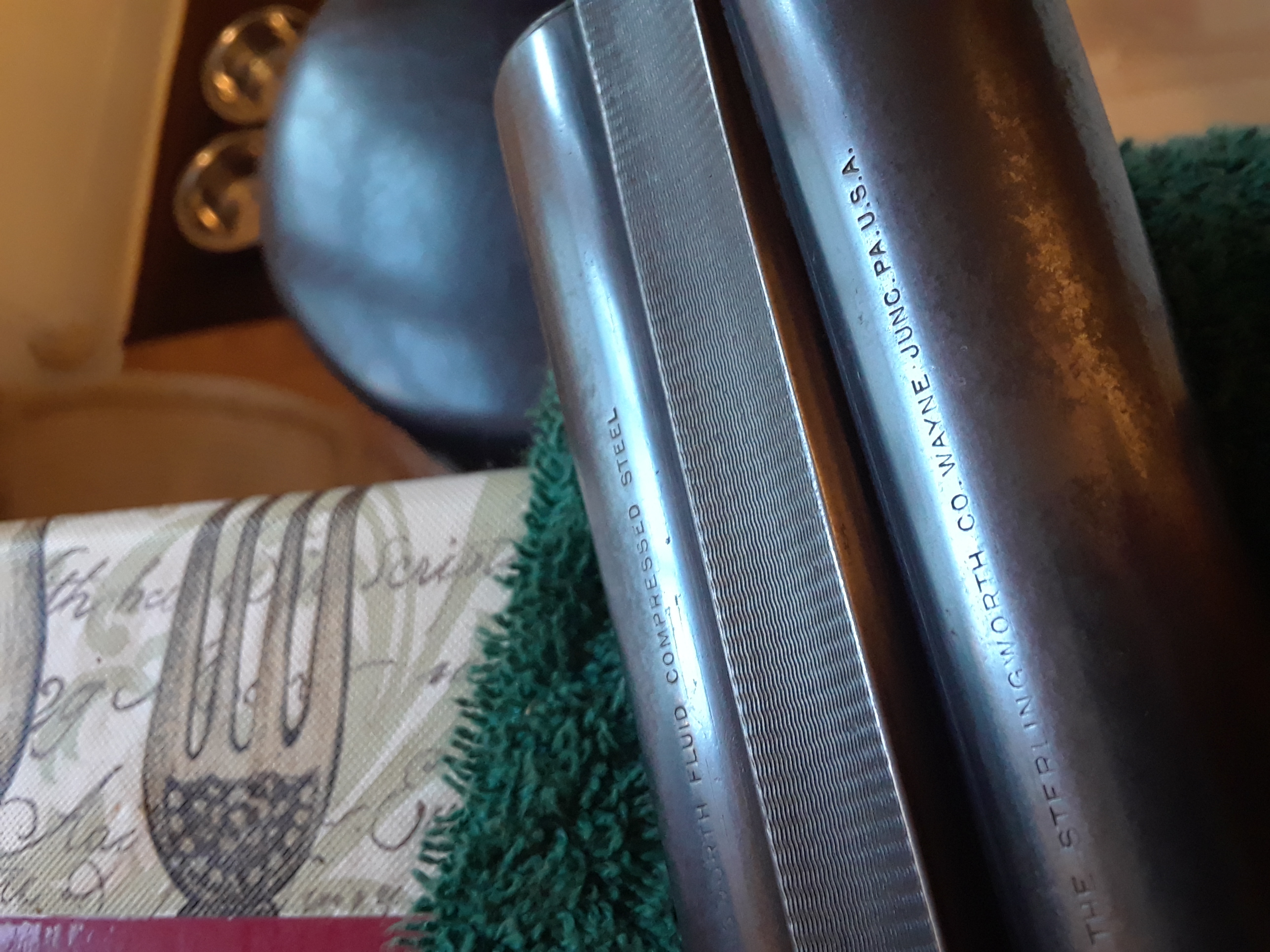

Probably at some point your barrels were improperly reblued with hot salts bluing which has attacked the soft solder leaving the result you see. Resoldering a set of barrels is not a job for Joe Shit the Rag Man, your local 870 parts replacer. To have it properly done by a qualified smith that knows what he is doing is likely a $1000 job.
I've been recording observed Sterlingworths since 1989, and yours is the lowest serial number I've seen. Previous was 50044. Is your gun's barrel address WAYNE JUNC. PA.?
If your barrels are really 32-inch, that would make this a very rare The Sterlingworth Co. gun.

Please, do not take this gun to your corner gunsmith. It should be professionally repaired and cleaned up. Get back to us with the markings and barrel length. Interesting gun. Where are you located? We can recommend a competent gunsmith near you.

It does indeed say Wayne PA on one side and fluid steel on the other(see pics).
It is only a 30 inch barrel though.

dont mess with it...looks like a real nice early sterlingworth......wipe it down with an oily rag and put it on the mantle until you are financially able to have it fixed by a good double gunsmith..maybe take it to a good double smith to have it looked over and get an estimate ..looks like original condition to my eyes....with a popped bottom rib.....cant tell about the wood checkering from your pics....

The wood looks to be badly over sanded from what I can see. Erased most all of the checkering. Also the missing grip cap has not been reproduced to my knowledge. I don't have a good picture of one, but it is like this one but without the blanked out area around the screw hole.

I'll have to get a pic of the checkering. It is still very nice and not worn at all. Can't see it in the pics I have posted. Yes, It is missing the grip cap and also the sight bead.

that through bolt in the head of the stock isnt going to help matters in getting the gun back in presentable condition....but then it is the 40th sterlingworth produced....and the lowest number that Researcher has recorded....lot of decisions for you to make on what way to go
