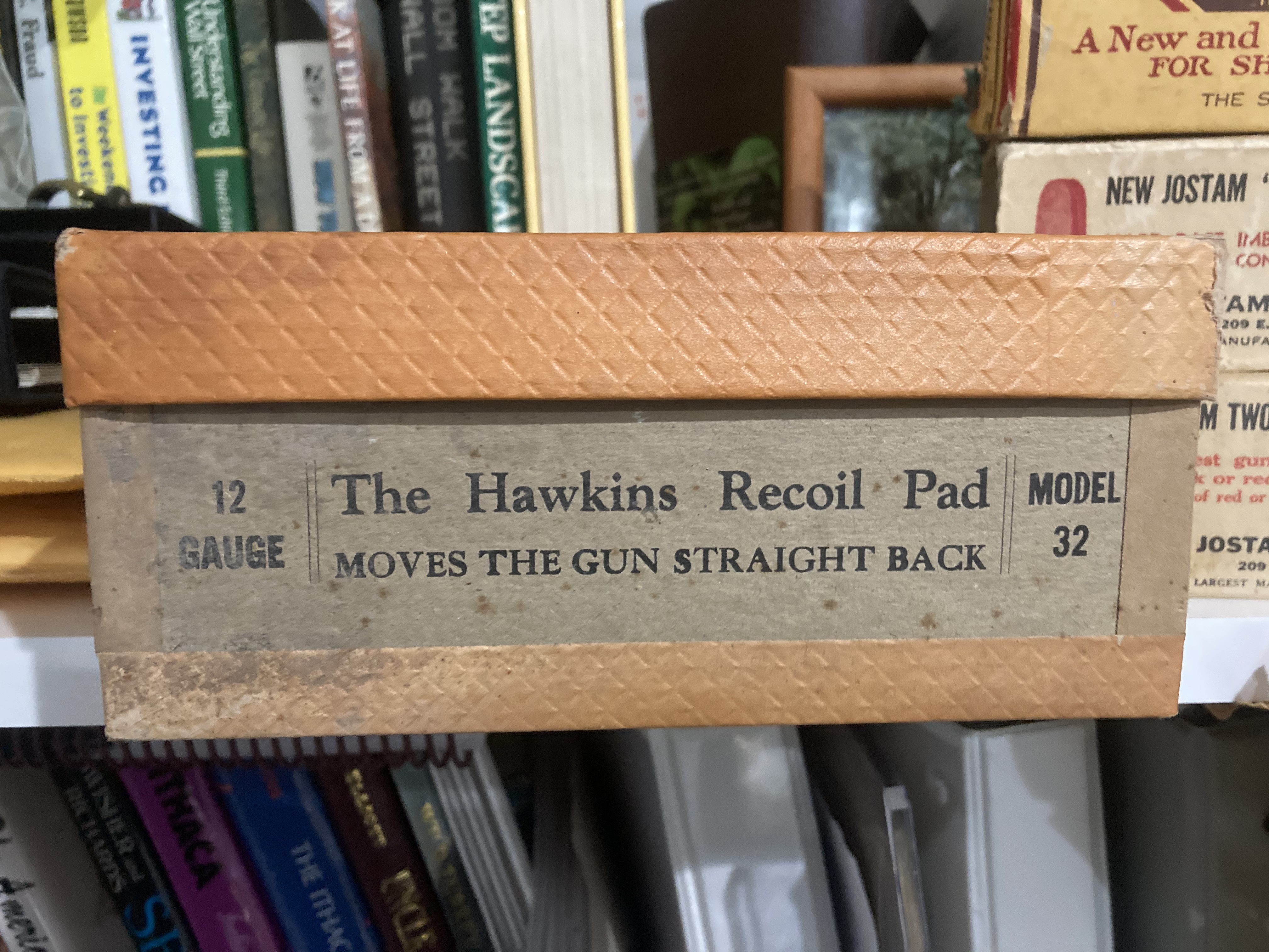

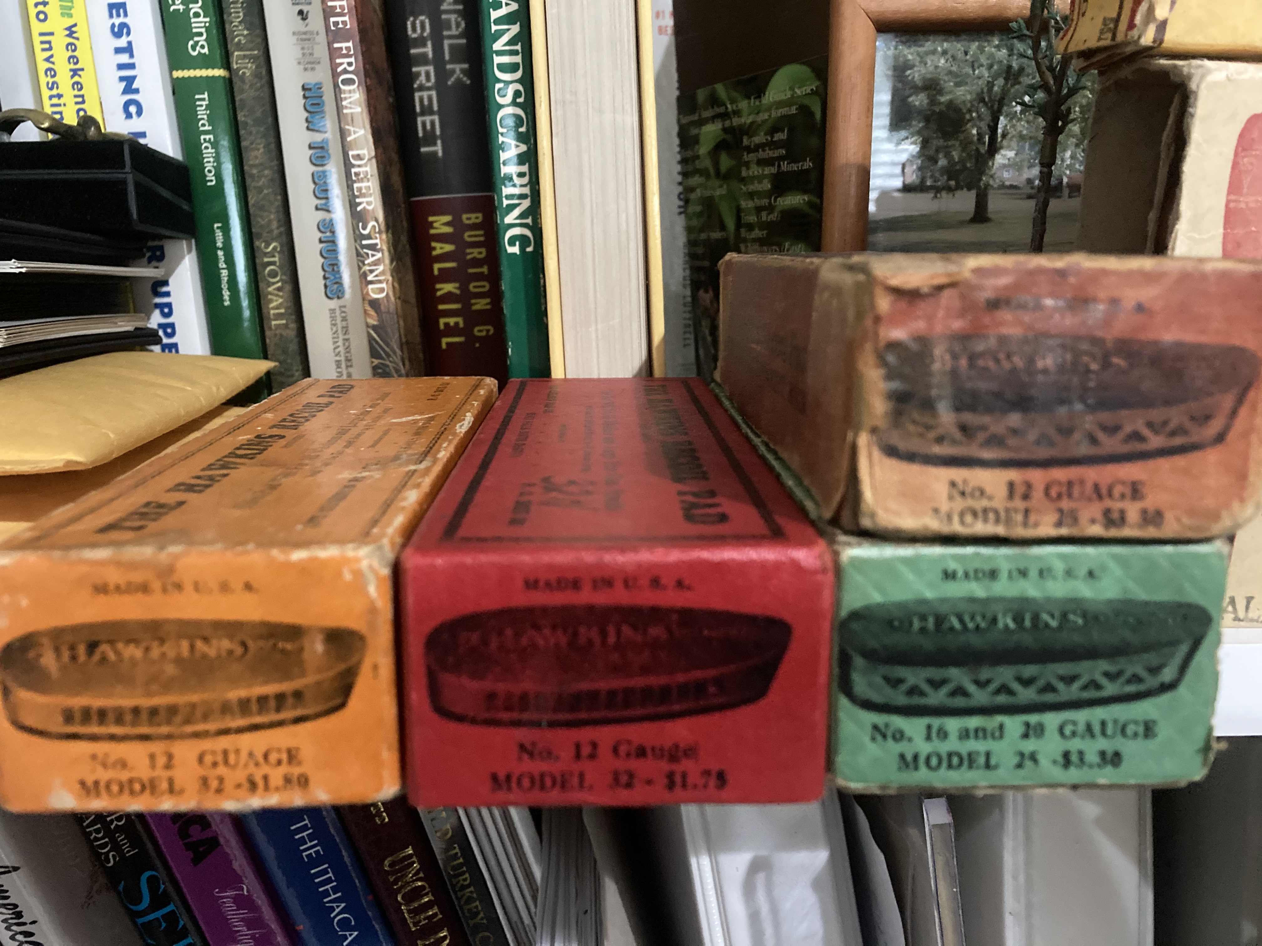

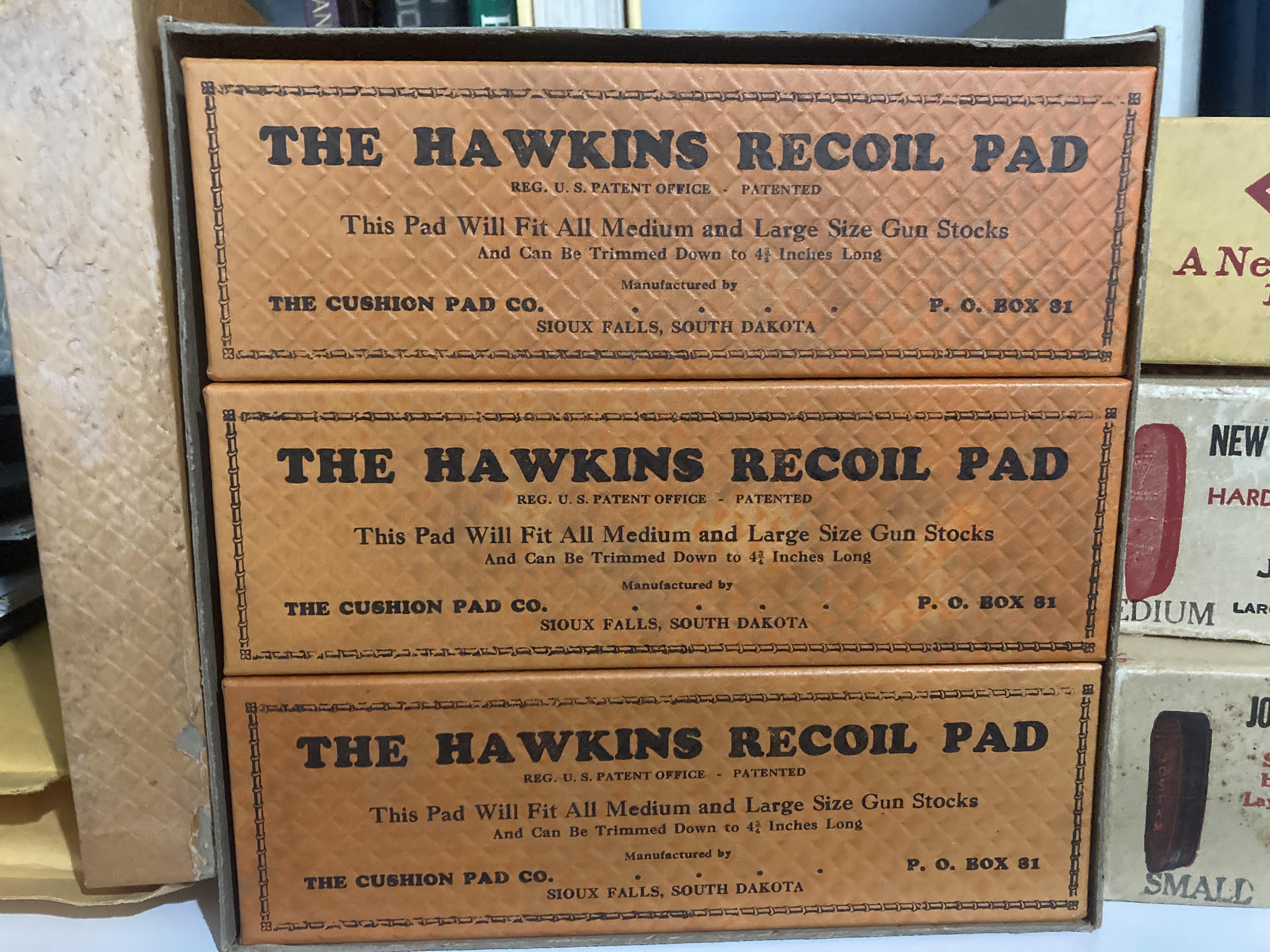

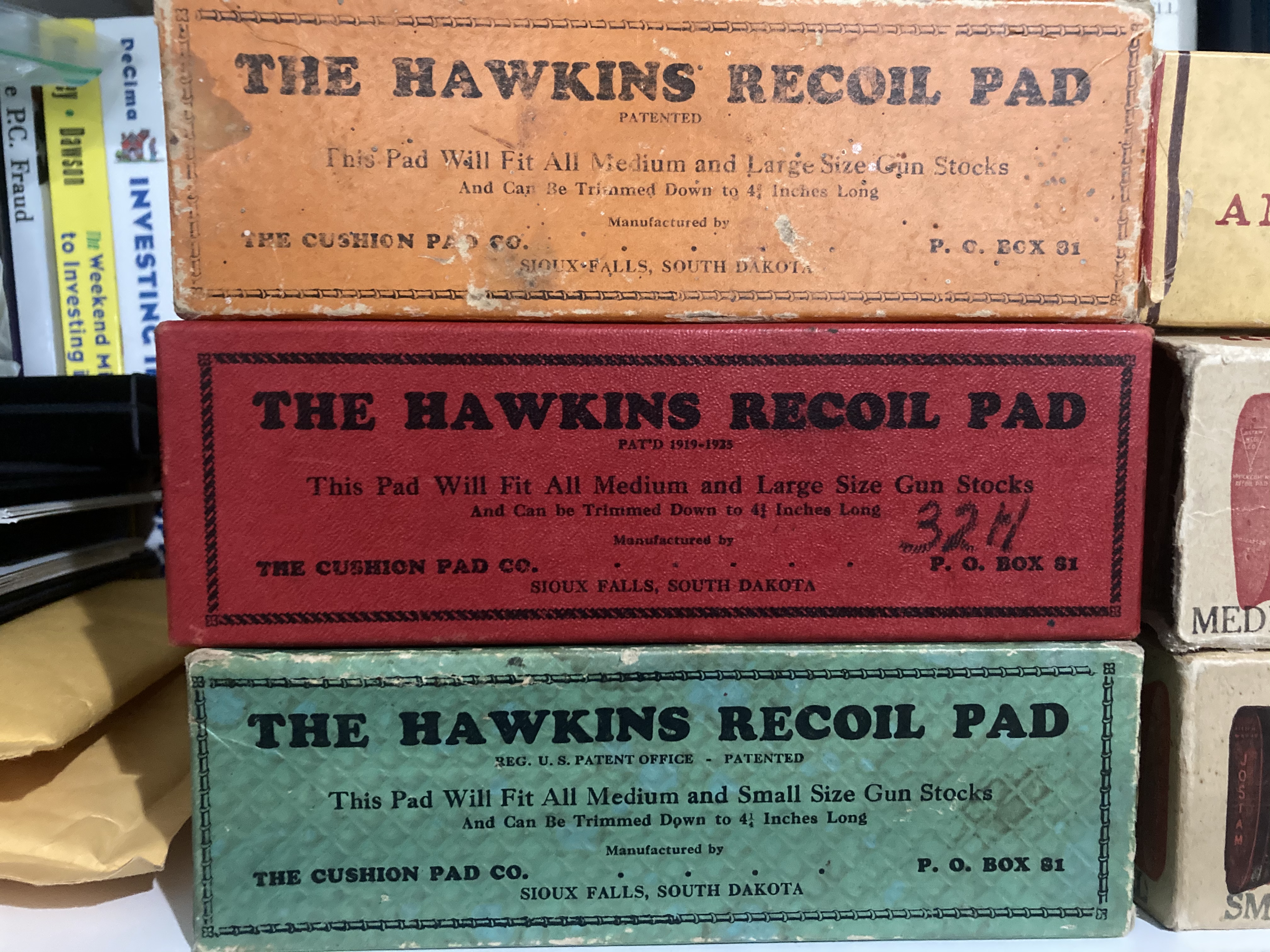

Re: Hawkins recoil pad
Here are a few pics of Hawkins NOS pads. Not a complete stock but will give some idea of sizes/choices offered
