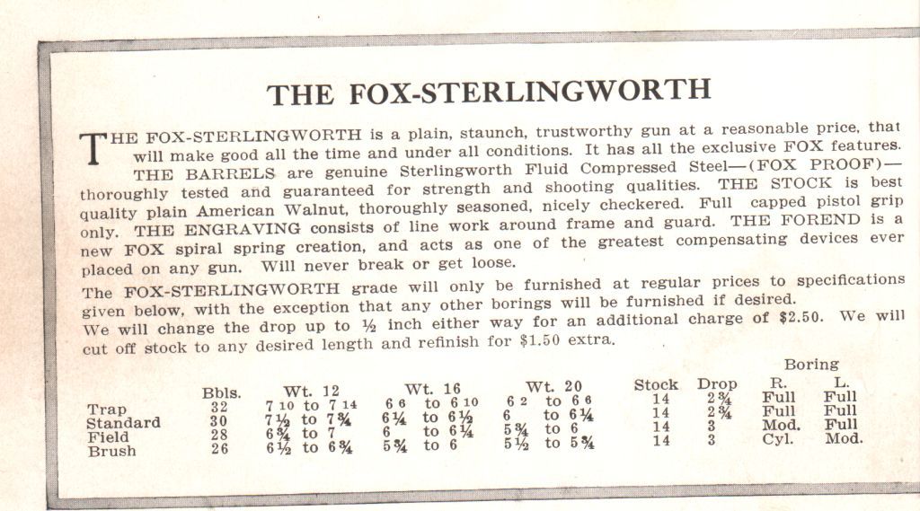

There were no choke markings on A.H. Fox Gun Co. guns. Here are the Sterlingworth pages from a 1919 A.H. Fox Gun Co. catalog.
There were no changes to Sterlingworth specs through the last A.H. Fox Gun Co. catalog in 1929. Normally the 32-inch (Trap) and 30-inch (Standard) came full & full. The 28-inch (Field) came modified & full and the 26-inch (Brush) came cylinder & modified. Other borings were one of the few options on the Sterlingworth.

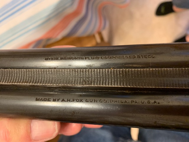

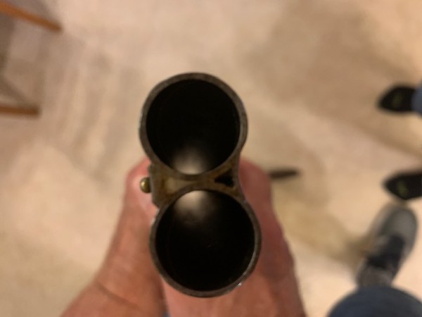

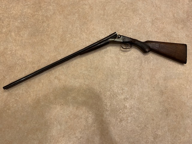

I appreciate all the help. The barrels are 30". I believe from the posts that both barrels would have a full chokes, but I am unsure.
I have attached some pics of my grandfather's 16 gauge. I doubt that the barrels have ever been cut.
Thanks again for the quick responses.

IMO, the have not been cut. A good barrel guy can fix the gaps between the barrels on the ends.

How long are those barrels? They look pretty long in the pictures. One should never use steel shot in these old doubles. They were made for lead and nowadays if one needs non-toxic shot one can use bismuth or "Nice Shot" loads from RST. From back in the days when these guns were being made I don't recall ever reading any restrictions about the use of lead buckshot.

He stated, below the last pic, that the barrel set is 30".
Only a gauge will tell for sure, but I believe they are choked M and F. Pretty sure I can see the difference in wall thickness at the muzzles.
Best, SRH
