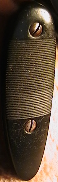

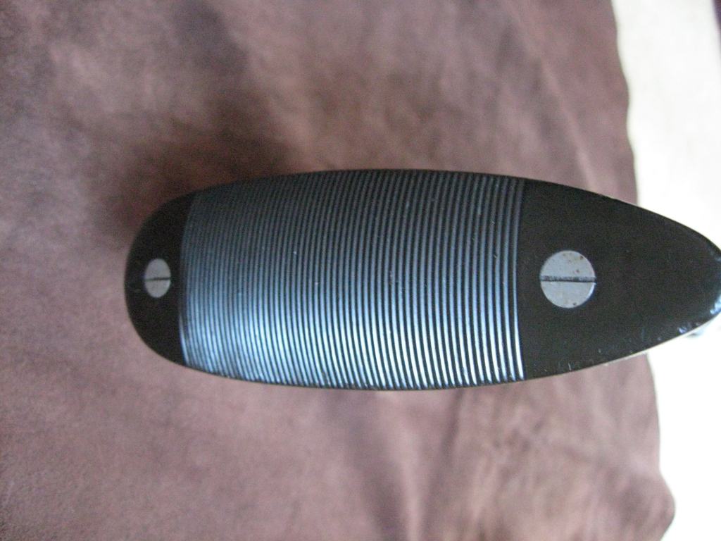

From my observations Philadelphia Arms Co. used a plain generic butt plate with horizontal grooves between the screw holes --
and a grip cap with horizontal grooves across the face of it.

Eightbore may be the only person that knows that number of serrations. The picture I used is actually of a Tobin as my only picture of a PAC butt plate isn't very good. My C-Grade pigeon gun has a straight grip and a Silvers recoil pad.

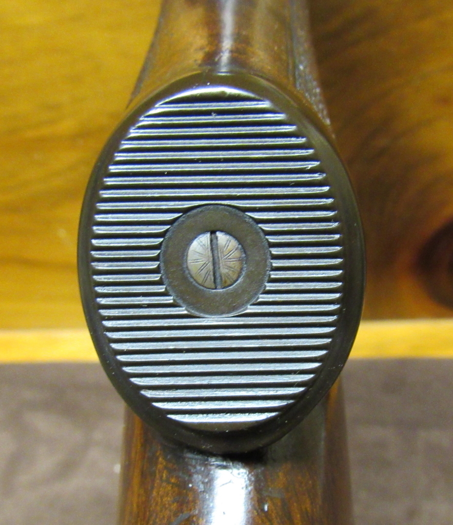

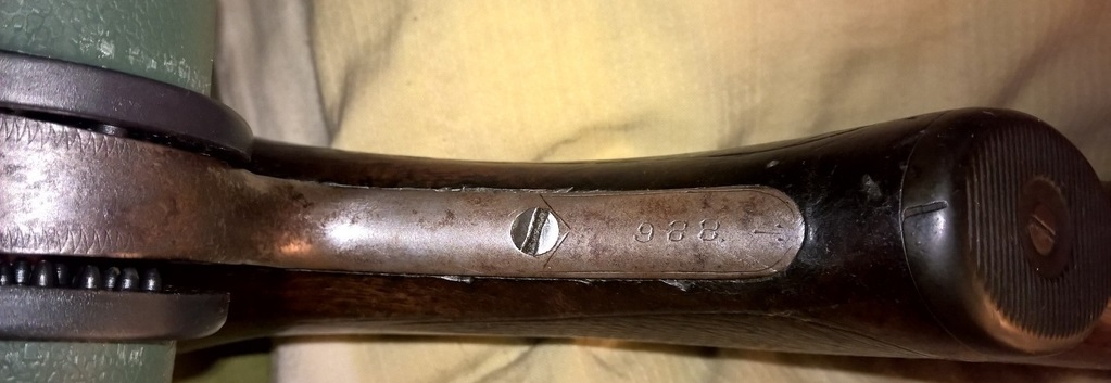

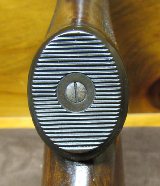

Found a couple of pictures of the grip caps.
855 08.jpg (21.82 KiB) Viewed 3371 times
Also, the article on C. William Hayward's E-Grade Philadelphia Arms Co. gun in The Double Gun Journal Volume Two, Issue 1, shows a very ornate, thick, butt plate, made to add about a 1/4 inch or so to a stock. I've seen that butt plate used on L.C. Smiths and other American doubles

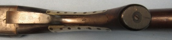

Dave Penland,
Very similar to what Dave Noreen/Researcher has shown above, here's the butt plate and grip cap from my Early A12 SN 7983. Maybe same style as used on the Philadelphia Arms Fox?
