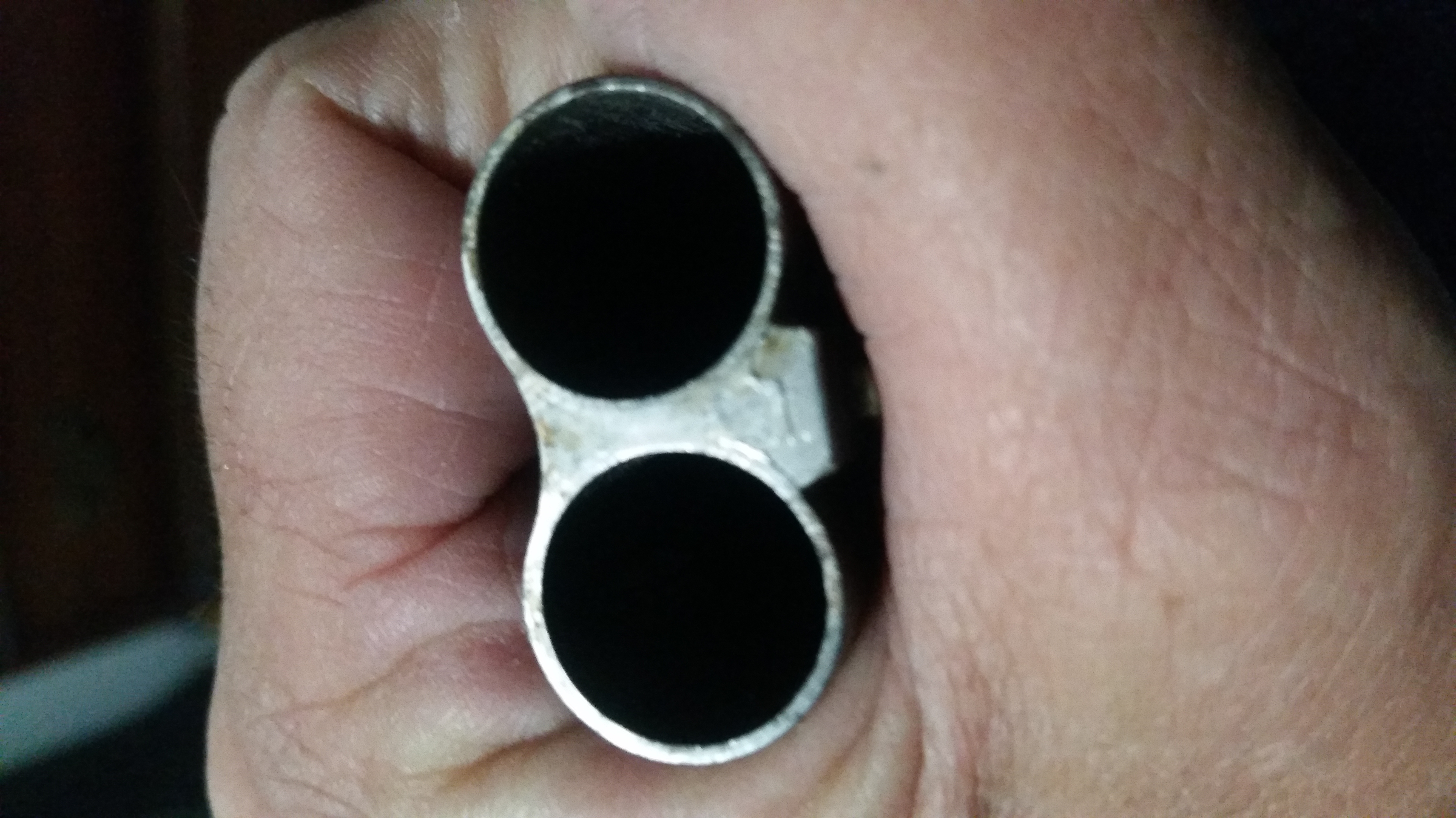

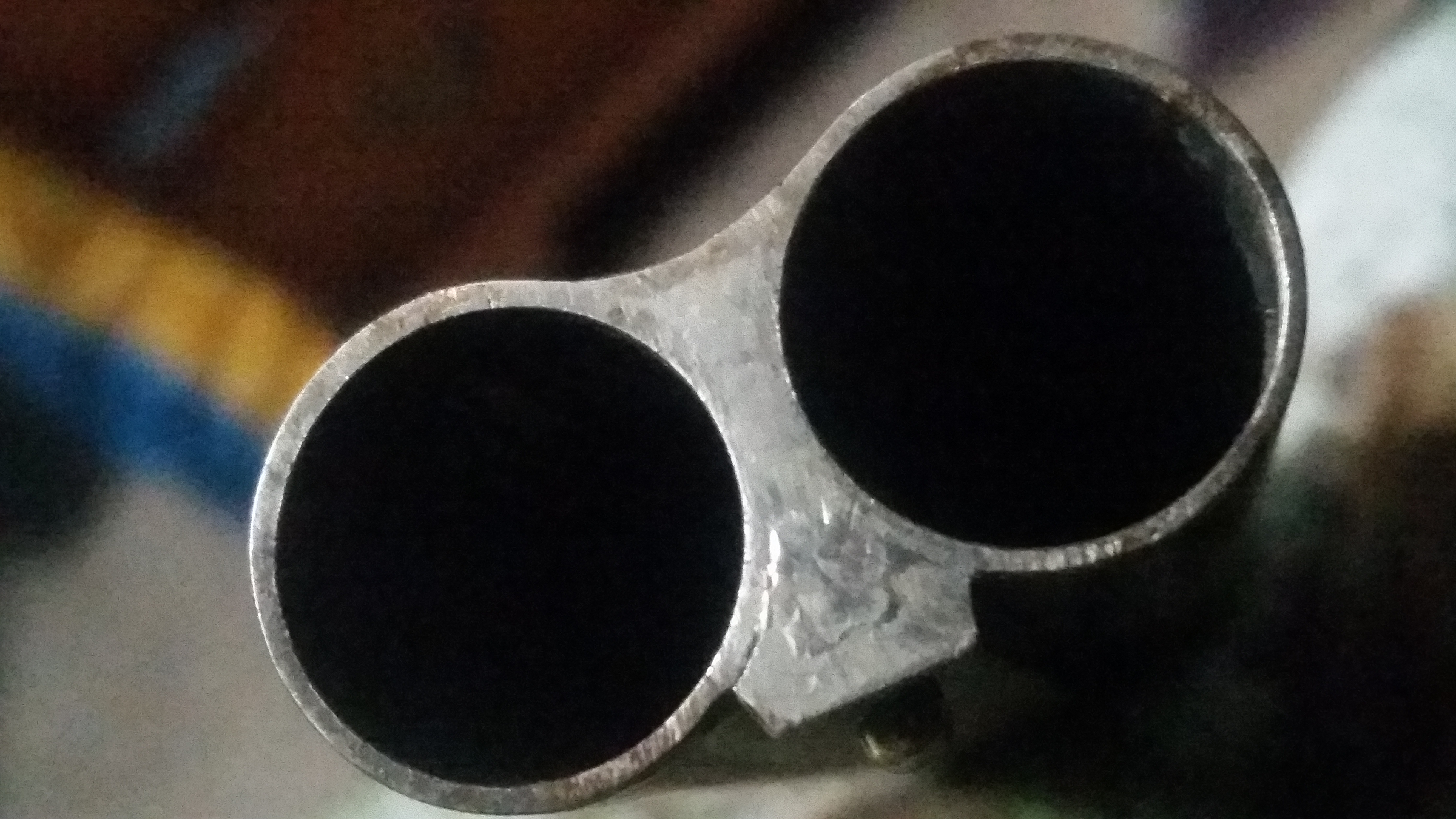

Figured I may as well ask this also.
On the card the gun started as a 28" full full
It is now 26 1/4 the question is on the cut was the job done well?

Your pic doesn’t have enough clarity to verify the area between the tubes. If done properly the top and bottom spaces would have steel “keels” that were fitted and closely soldered in place. Lesser gunsmiths usually filled the two spaces with solder. A better pic that’s in focus can tell which it is.
Also a good top view pic (looking down) can tell if the tubes were cut square or cockeyed.

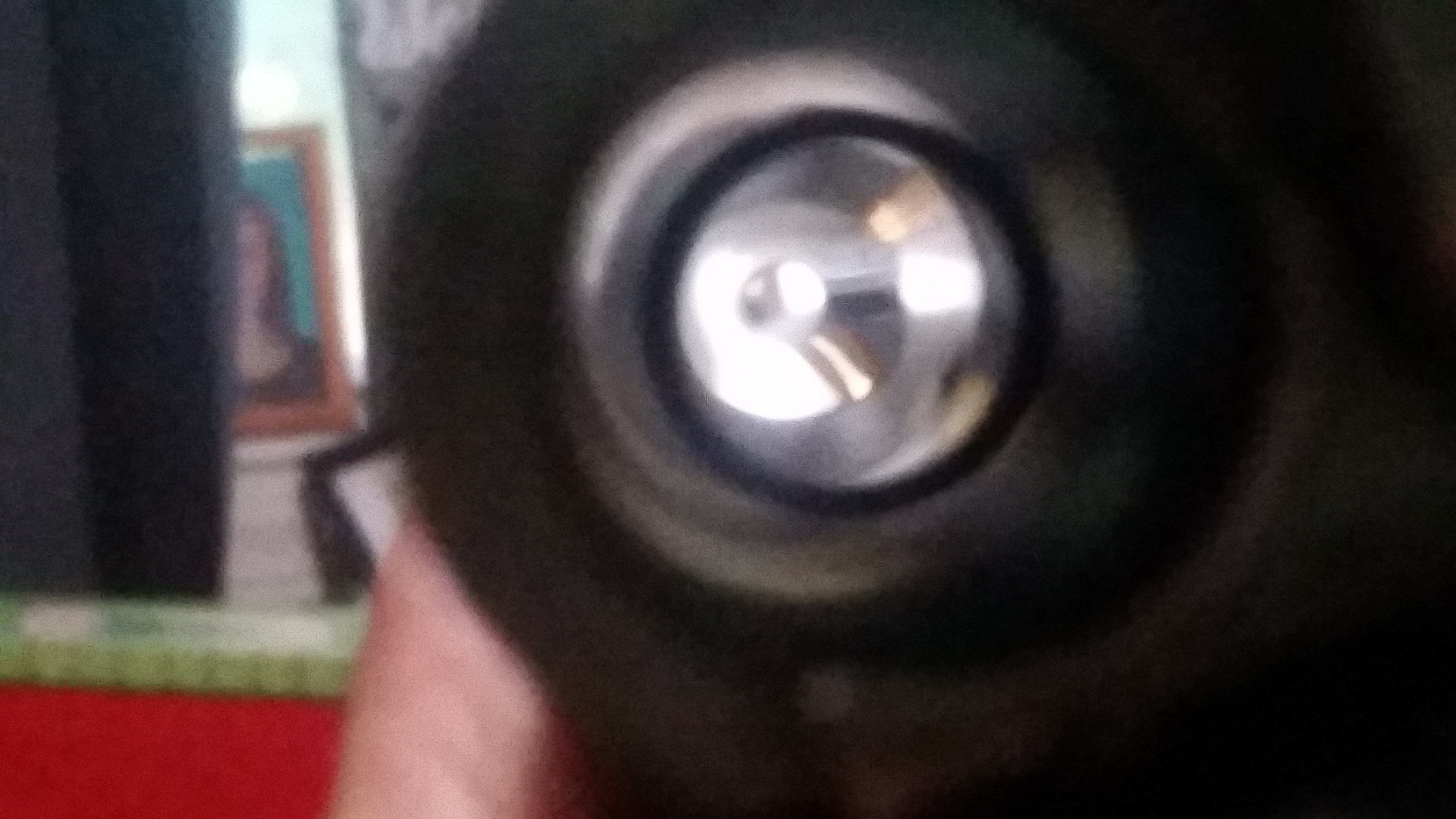

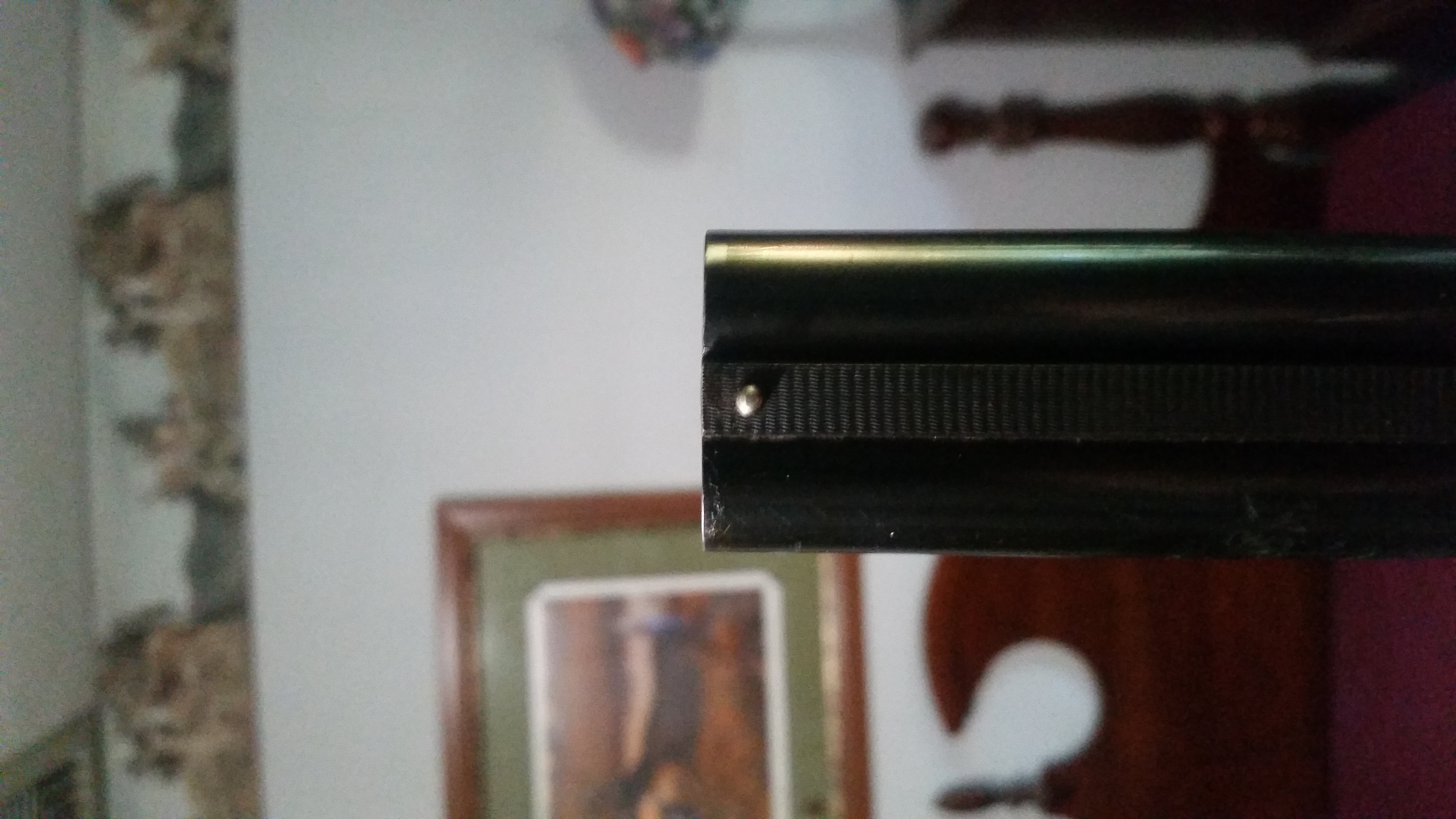

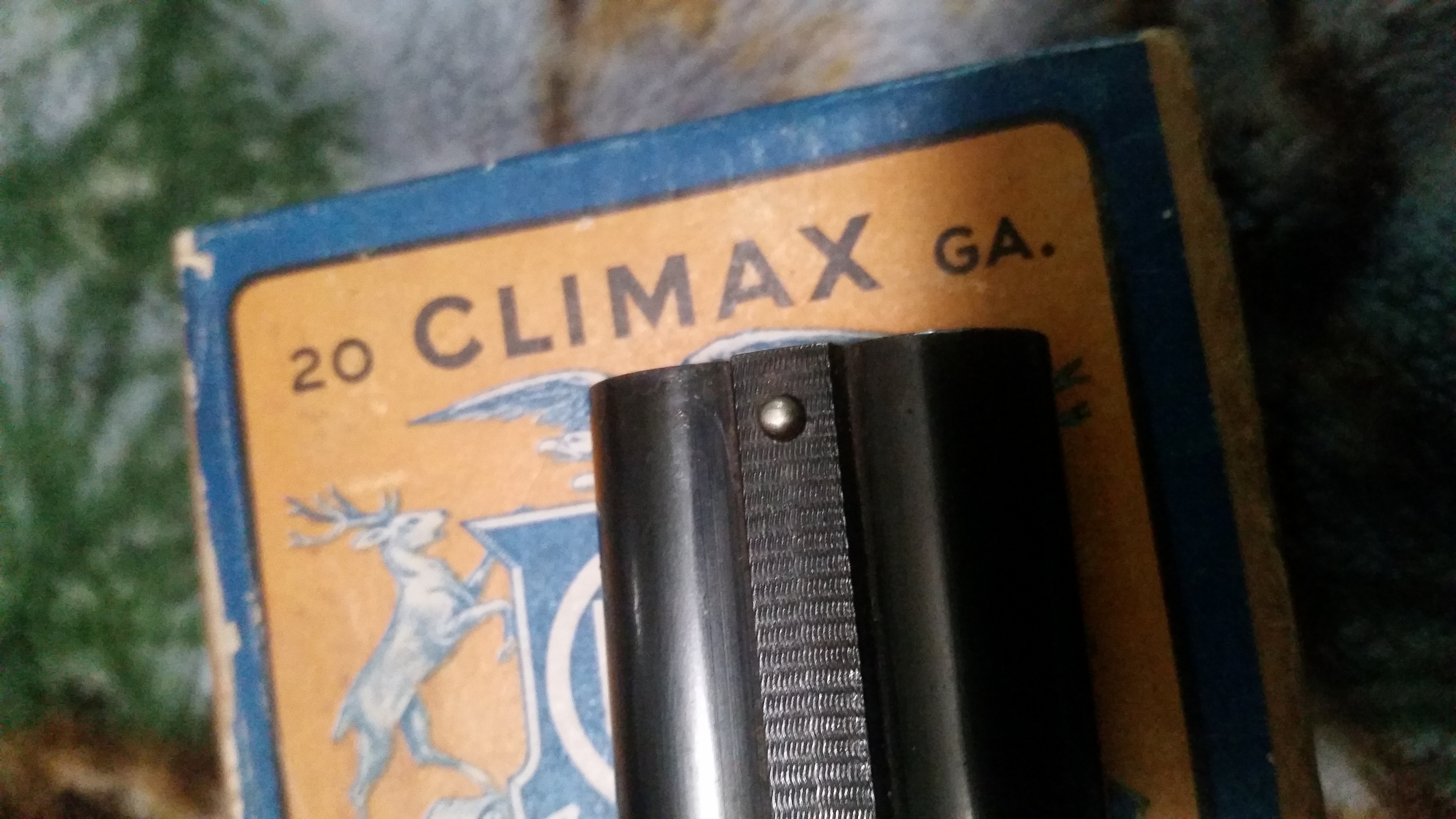

Re: Looking for info on a Utica NY fox....another ? Post 46
Post by Weatherby »
That picture was bad....lol
Any better ?
Last one is out of focus but may have what you asked about ?
Center pic - from that view both muzzles look to be very slightly angled backward relative to the rib. Maybe 1-degree or so. Point of impact (POI) testing on paper, average of at least 3 shots per barrel, will tell the story if the muzzles are OK.
The sight is centered = good.
I still can’t tell if the muzzle voids were fitted with keels. Maybe someone with a large monitor can expand that last pic and comment?

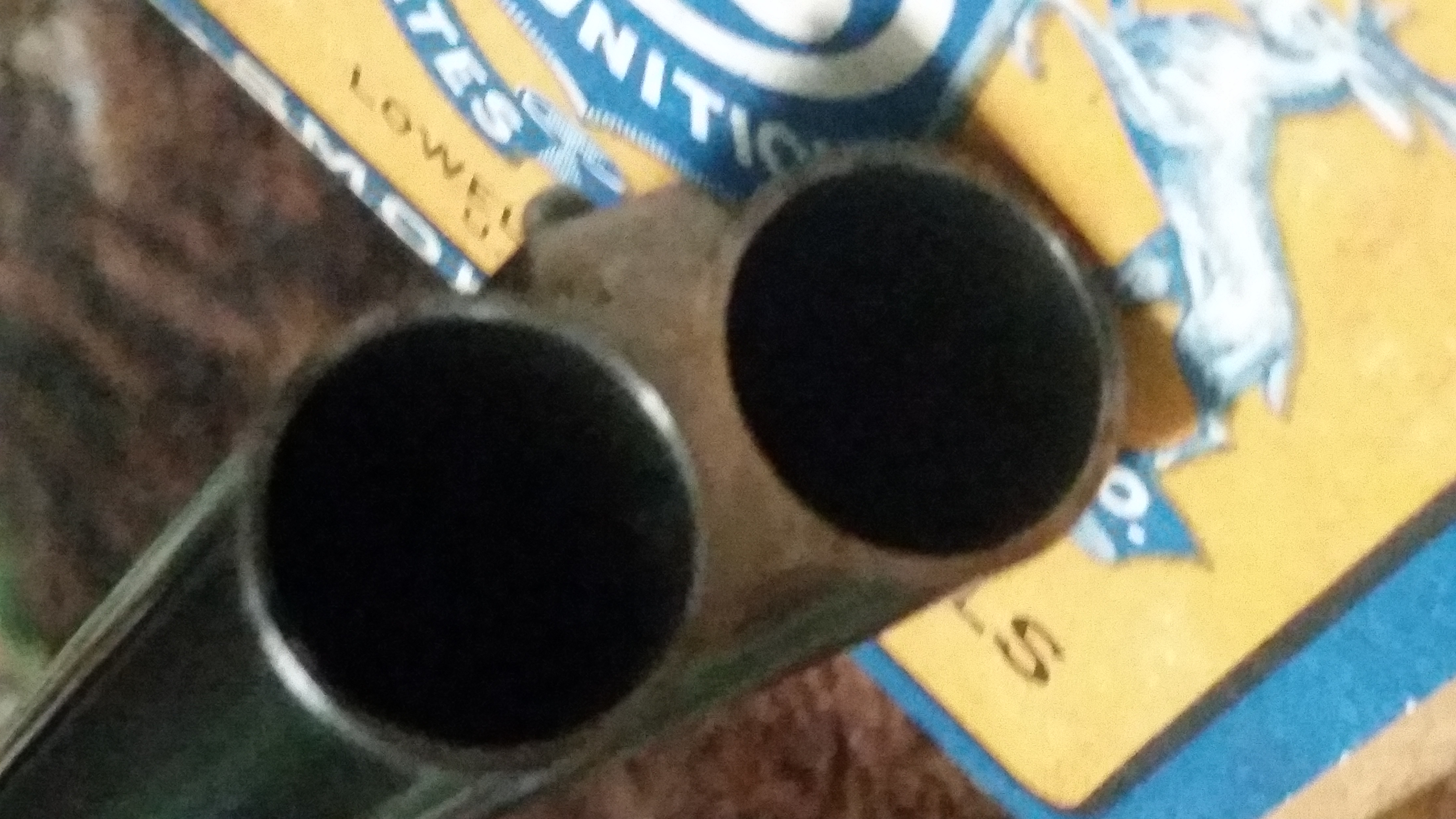

Post by Weatherby »
I'm trying Frank....lol
Not very good ....but trying.
I actually think one is clear.
Paul, the muzzles look nice and straight in the first pic. Second one still isn’t definitive on the presence/absence of keels but that’s probably a moot point since you cited the barrels are 26-1/4” and the Record card shows 28”. If solder was used to fill the voids after cutting and if it appears well bonded it should stay put. I'll post a pic of a Fox muzzle sans the keels on the Members Forum. P.S. the bores at the chokes look slightly elliptical in the horizontal plane; maybe that's just a visual effect from the camera you're using. If not they can be easily made round by a good double gunsmith.

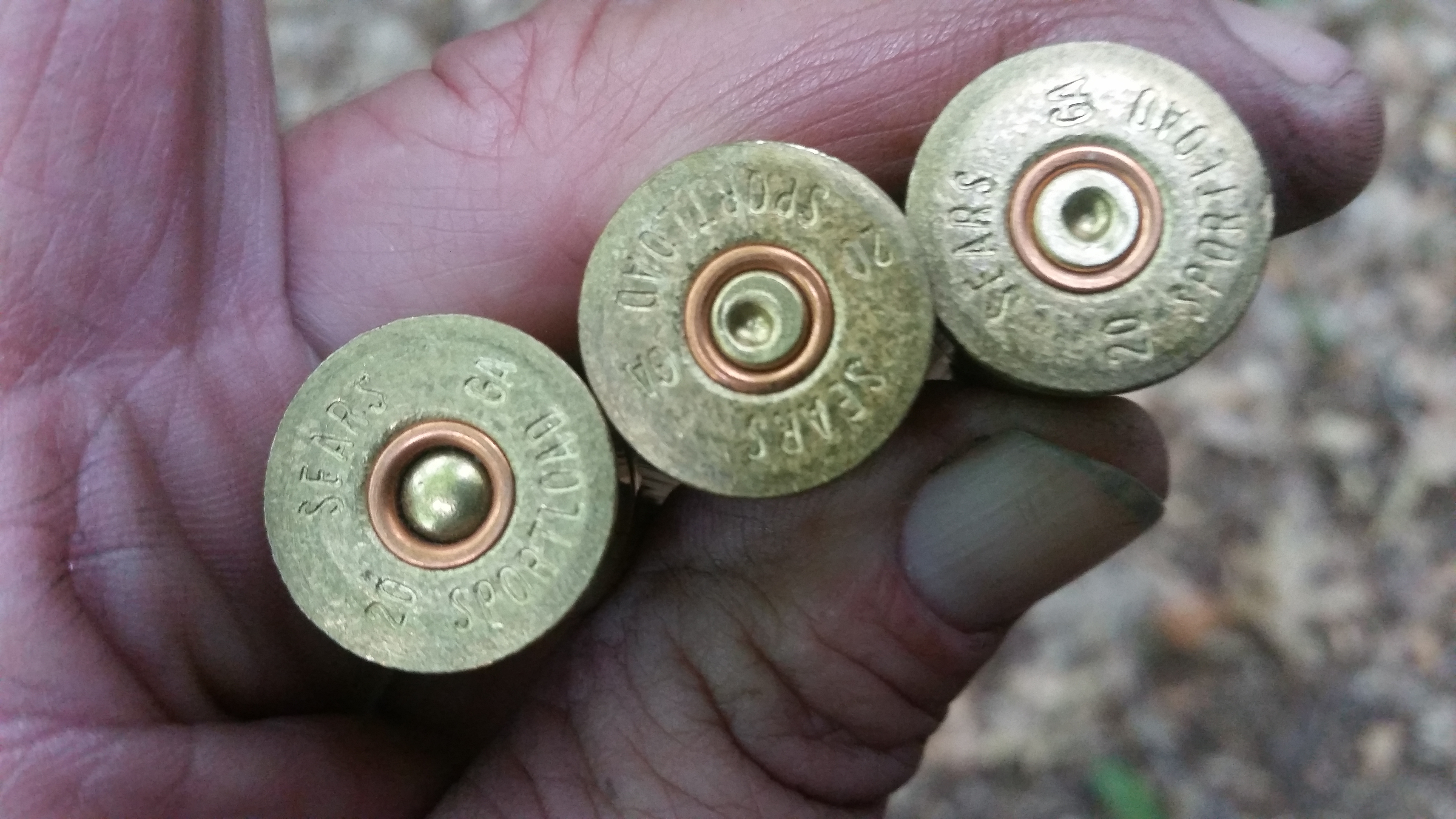

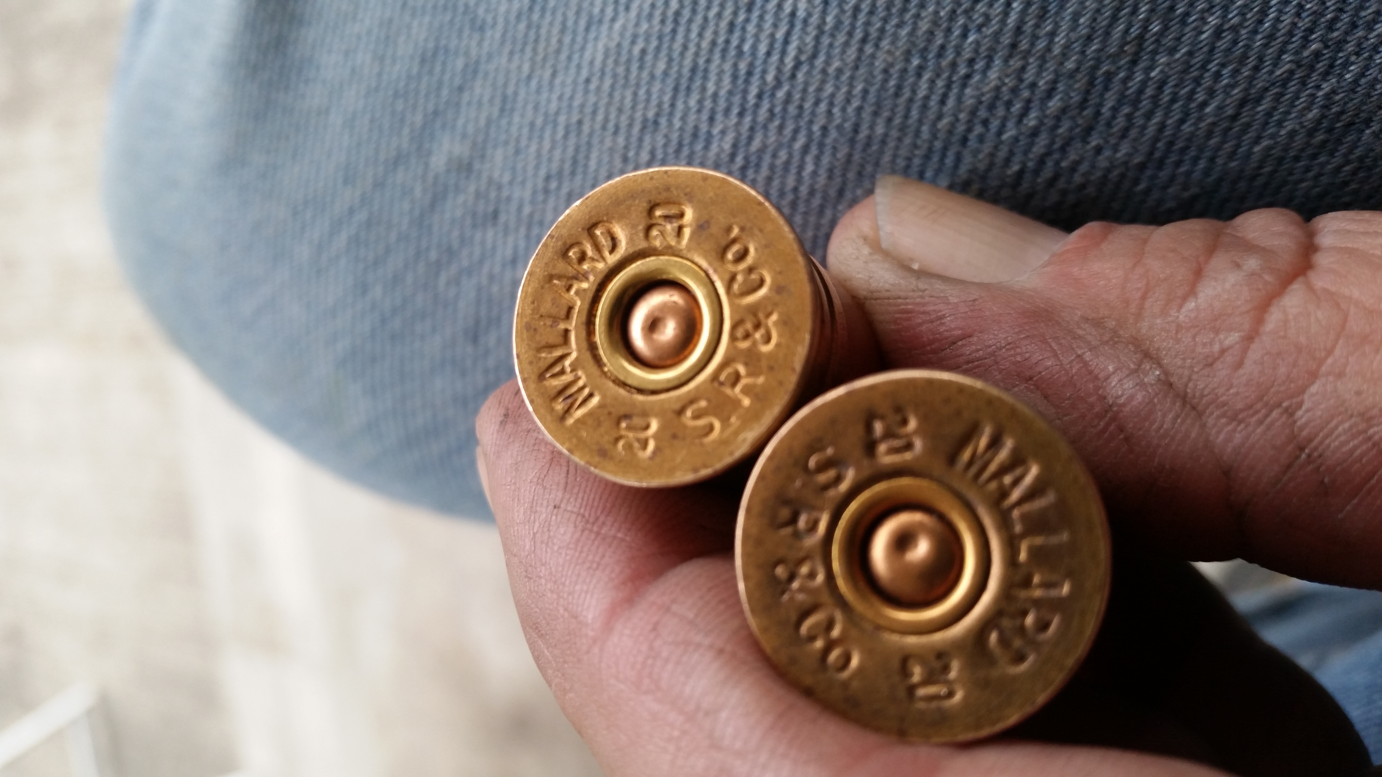

I finally brought it out for a function test yesterday.
I brought some old paper shells and tried 6 all failed to fire. The strikes looked a bit weak to me.
I put some kroil into the firing pin holes and let it sit until today. I also brought a bit more modern shells and got the bang from both barrels
I think it's been a long time since this one's been out to make some noise.
Glad to hear that she fired. Those old shells may have been the issue vs. the gun itself. Careful on over doing the oiling internally as I am sure you know. You better get that gun on some grouse/woodcock!!
