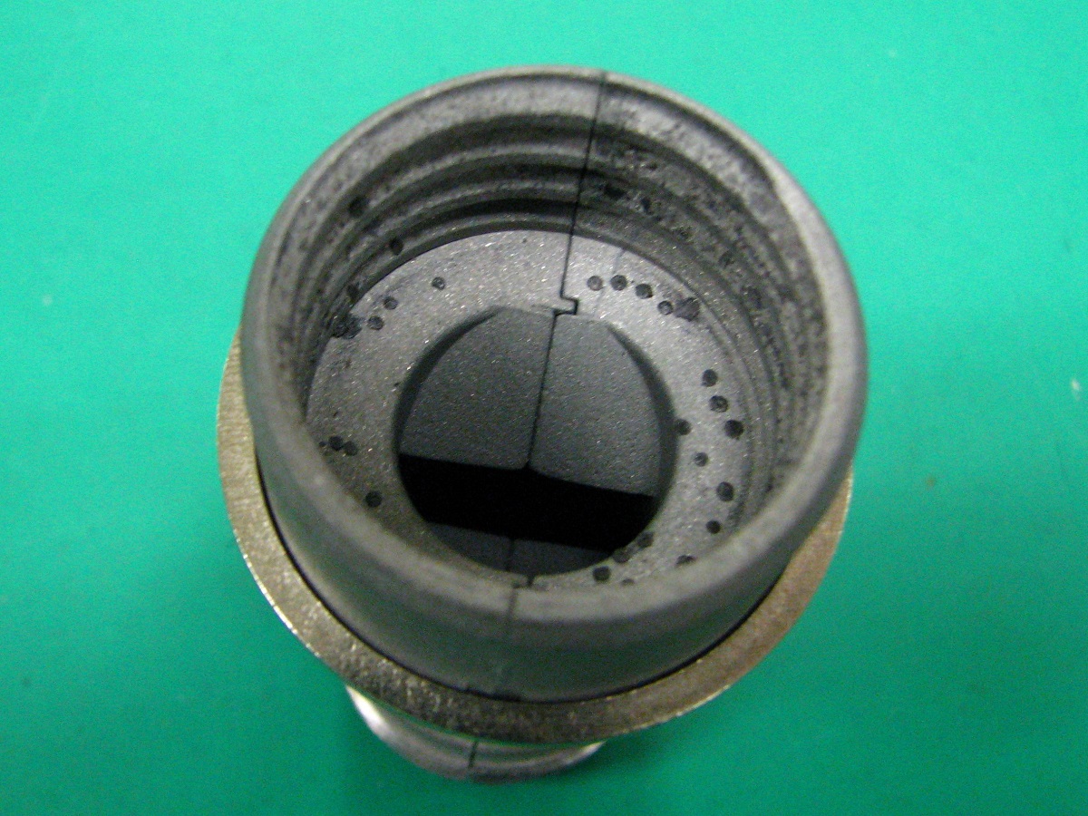

FMI, I’m attaching three pics:
1) See how the metal base on the hull expanded into the cut-out in the breech that holds the left ejector. The hull base in that area is now eccentric by .008” and mind you, the Gun Club hulls are unibody and don’t have a separate base wad.
2) The second pic shows the flattened primer with the start of a crater rim, and how powder gasses escaped around part of the primer pocket; this is a twice fired hull and the primer wasn't loose in the pocket
3) Last pic shows how the plastic hull material (second hull from the right) extruded forward by about .060” as compared with the other fired hulls shown for comparison.

Jim DeMunck, a world class engraver and a pretty darn good gun mechanic, follows the forum occasionally but not a registered user.
He sent me the following in regard to the suspect overcharge in that reload:
"Bill,
I was reading the thread on the Fox Forum about the overload/reload in the Win21.
viewtopic.php?f=46&t=9572
The one pic he included of the base of the shell is very familiar to me.
This one: Image
See the grains of powder stuck between the primer and the primer hole in the case? That shows that there was some powder from the previous drop stuck up in the drop tube.
When the next sized and deprimped shell moved over into position to station #2 (MEC9000) to be primed and charged, the new primer drops into place.
But before the deprimed hull can be brought down on that new primer to seat it in place, that stuck charge is freed from the drop tube (machine vibration?) and falls into the open hull.
Being that the hull is not yet primed some of that powder leaks out the back as the new primer is being seated. You get exactly what you see in the pic.
A seated primer with some powder grains stuck in place around it.
The rest of the 'extra' charge is still inside the hull. Then the machine drops the regular charge in on top of that. You have the extra charged hull. The one before it was the squib.
That's exactly the problem I was having with that last jug of Clays. Too light and fluffy & getting stuck in the drop tube.
I use a MEC 9000 also."
End of Jim's comments.
Seems to be pretty logical explanation.

Bill, thanks so much for posting and please thank Jim for me. His explanation makes perfect sense. The hull that's pictured is still on this desk with the computer; I just took a paper clip and picked at what I thought was powder residue around the spent primer. What I found was indeed unburned grains of E3 Alliant powder that were squashed between the rim of the primer and the base of the hull, against the standing breech and outside of the powder burn area of the hull.
Undoubtedly I had a partial blockage in the drop tube on my 9000 press and it dislodged and caused an overload in the next shell in the carousel. I still don't know why that happened but have gone to emptying the powder cannister after each reloading session and also using a piece of brass window screen in the funnel used to fill it. I'd also checked the powder drop tube right after this happened and found it clean as a whistle.
