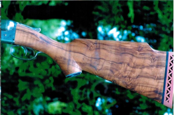

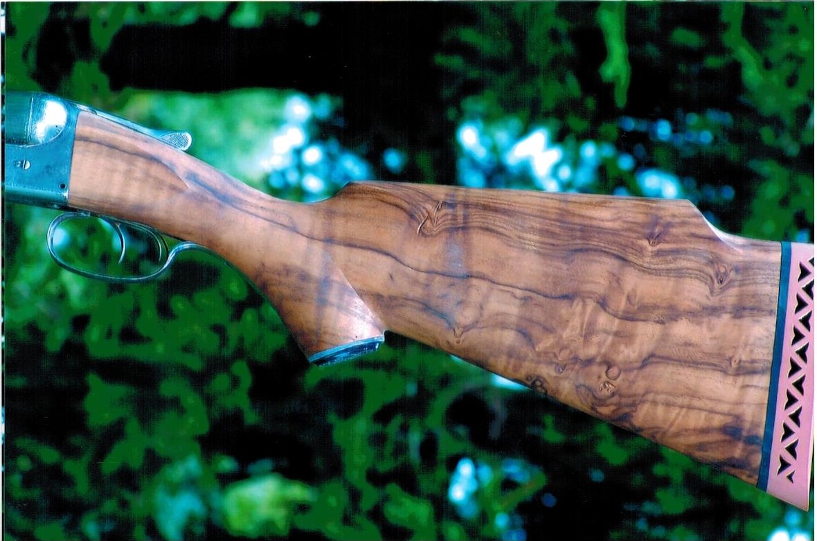

The problem with the available Hawkins repro heart-shaped openings pad is that it is the huge 15 hearts size and will only barely work on a large-size stock, like my big 2-frame Parker Bros.
Probably best suited to an Ithaca NID Magnum-10!!

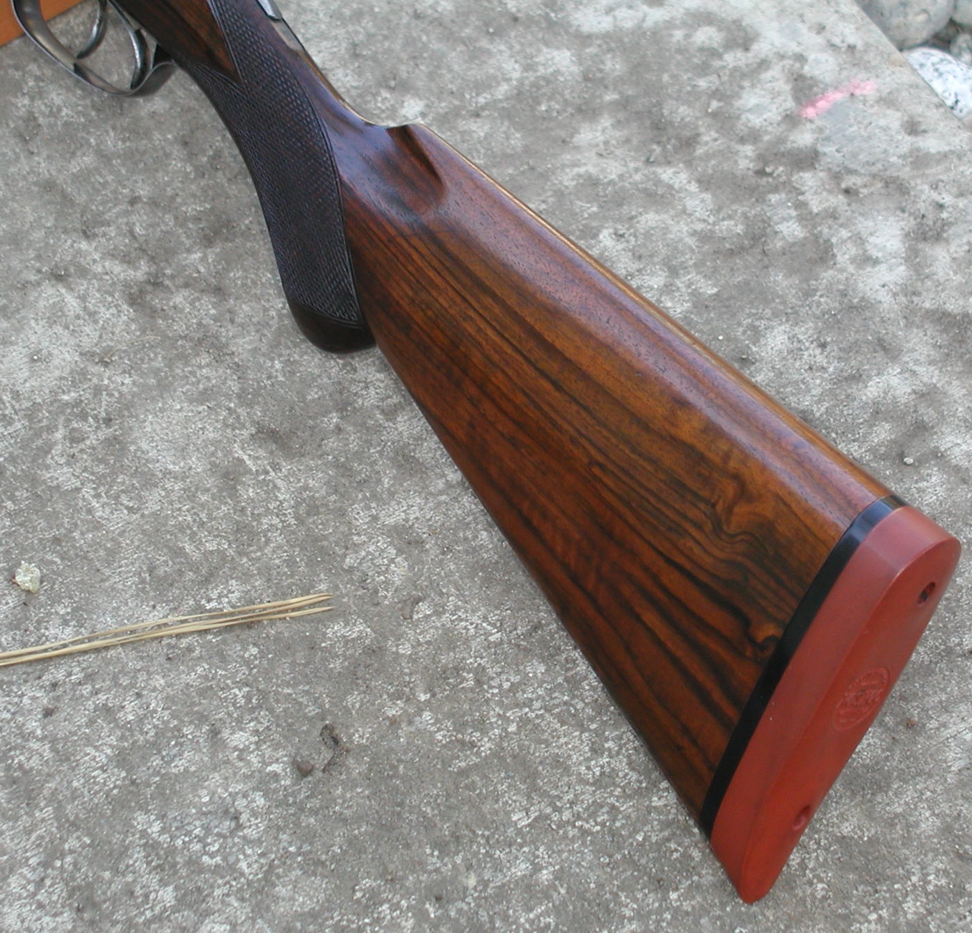

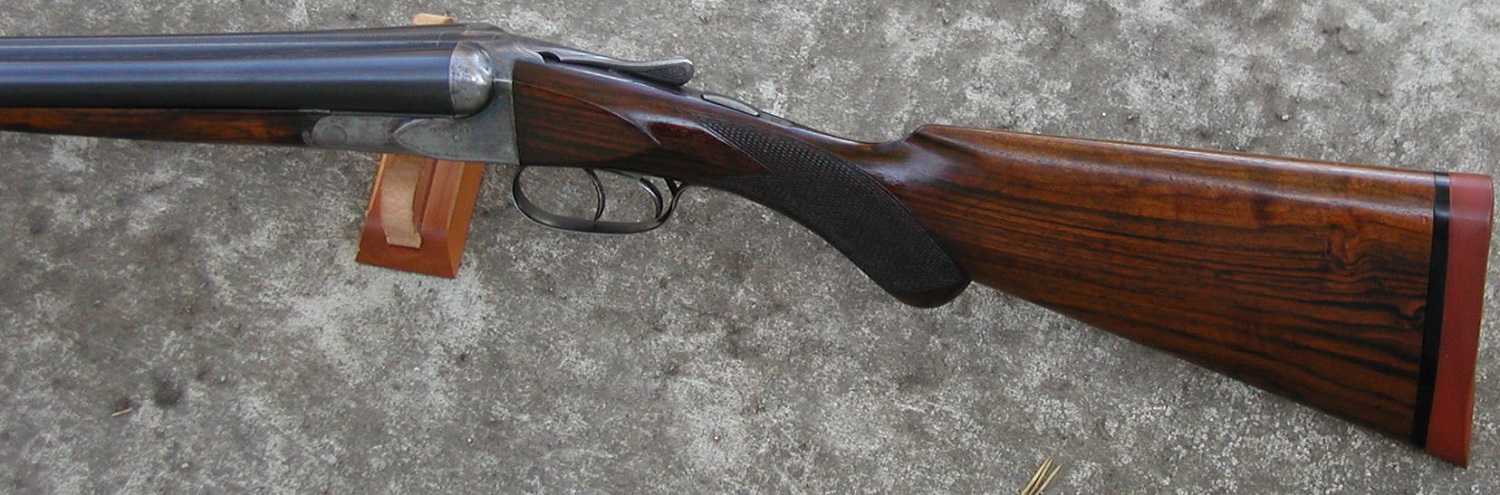

Though the gun is at least a decade older than the No-Shoc pad, I've had this NOS pad I got from Clarence Bowman at a Vintage Cup on my favorite hunting 20-gauge for a dozen years now.

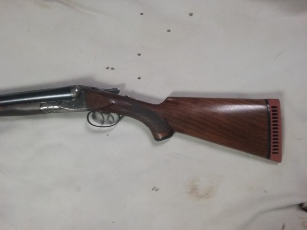

Went to my shop to put on a NoShoc and found a Hawkins that had been taken off a Parker I had. It was already close to fitting and one screw hole was usable so I only had to put in one new hole and shape the pad. The 13 7/8" length was not long enough for me so now it is 14 1/2 inches and I believe I will be able to shoot it better. The slip on leather pad just did not work for me, and I did not have to alter the stock for the new pad. Thanks for the replies.

Has thanked: 2883 times
Been thanked: 1795 times
Re: PAD FOR 1935 AE 12 GA
It looks nice!
