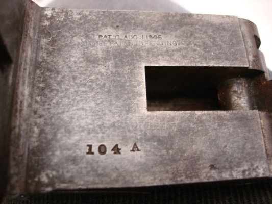

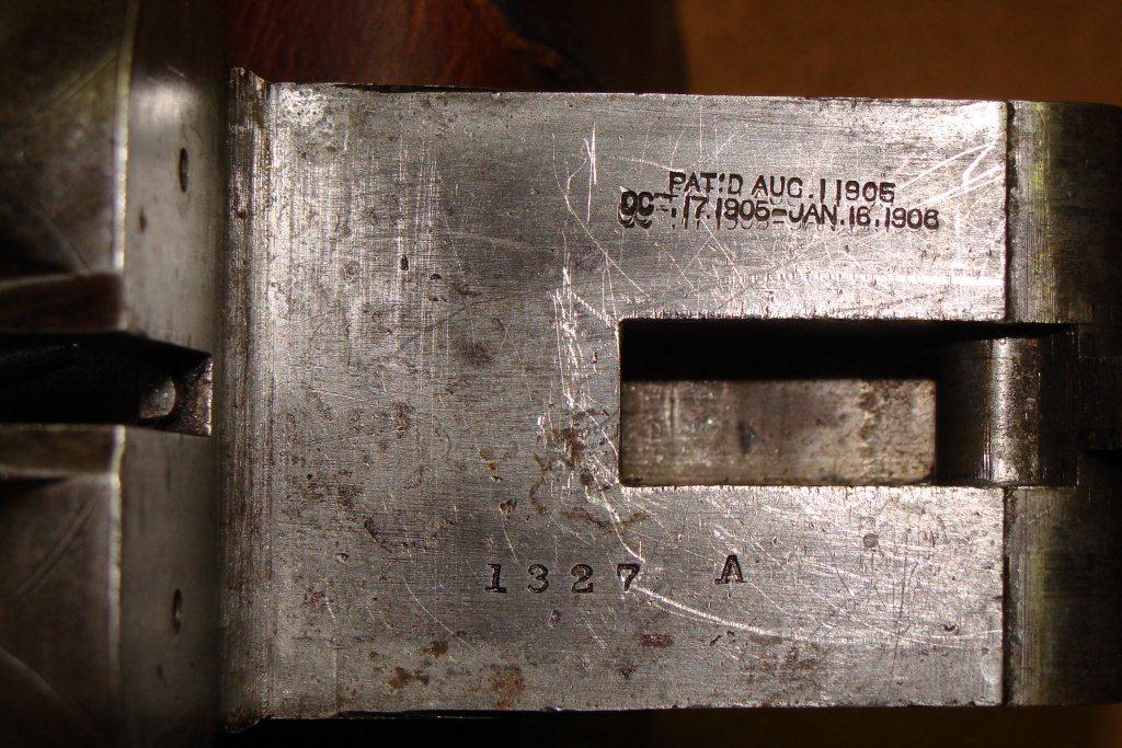

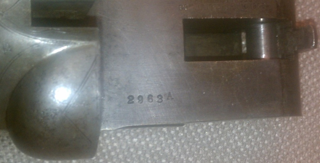

I've never seen a grade letter with the serial number on the exterior of the trigger guard back strap. In the early Wayne & Bristol Street years the grade letter was stamped pretty close to the serial number on the watertable.
104A
104A
104 A 03.jpg (54.03 KiB) Viewed 7954 times
1327A
1327A
2963A
2963A

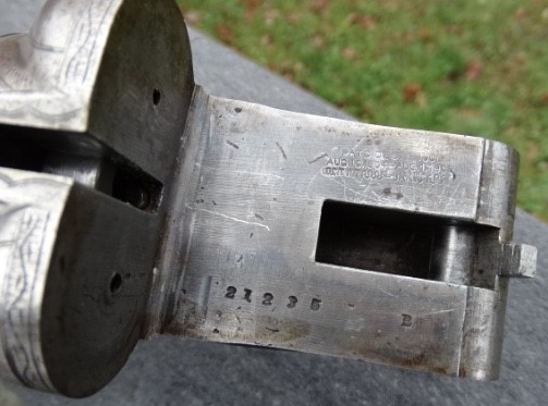

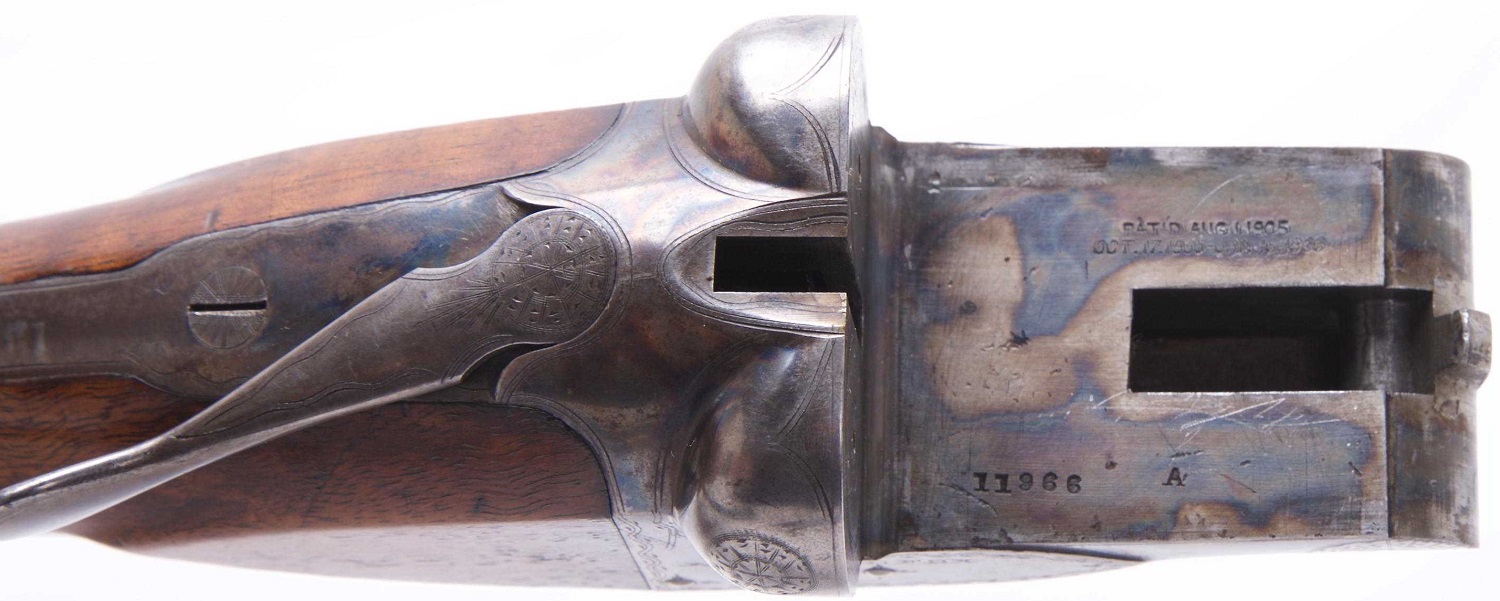

After the move to North 18th Street & Windrim Avenue the grade letter moved a bit farther away from the serial number on the watertable.
11966    A
11966 A
21235            B
21235 B
21235 12.jpg (58.46 KiB) Viewed 7954 times
Posts: 6227
Has thanked: 462 times
Been thanked: 2444 times
Re: Serial number question

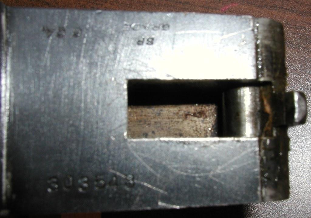

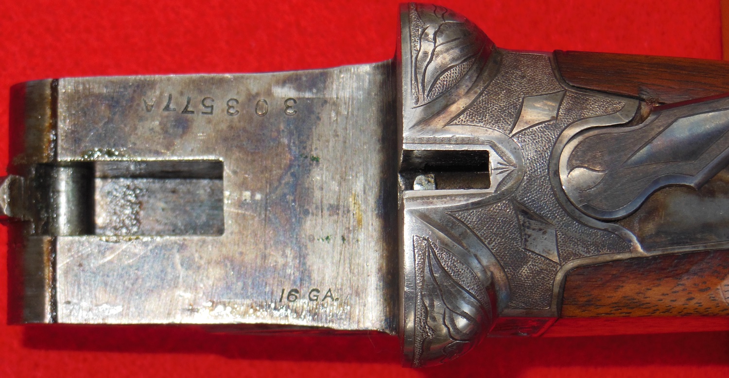

By the Savage years they weren't sure where to stamp the grade --
303548
303548
303577A
303577A
