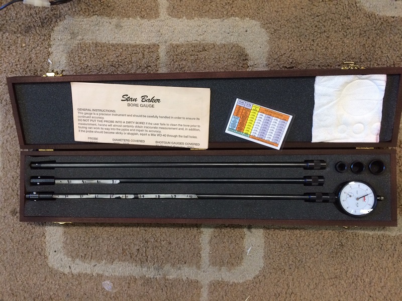

It's JMO but for those into vintage SxS's there's not much sense in buying something with just enough length to measure chokes. How about that bulge 10" back from the muzzle that was struck over and spot reblued? So far I've avoided three costly mistakes on such guns and paid for my Baker many-many times over.
The Baker bore mike I often refer to here is the out of production Stan Baker Bore Reader that can be found from time to time on E Bay etc. When made, they were available in specific bore sizes, i.e., 12-gauge, or as a combo set with (3) interchangeable stems that could handle everything from 410 to 10-gauge. I have the combo set and it's dead nuts accurate, repeatable, and the linkage from the measuring head to the dial indicator responds very quickly. None of which I could say for the el cheapo mike I had to start out many moons ago, or for another one I had after that. One advantage of the Baker mike is - with some experience - you can "feel" different surface finishes (degree of polish, or RMS number as a machinist might say) as the measuring head runs the bore. That's good to know because so many shotgun bores have been polished and that will throw off the patterning even though the constriction might measure X points for Full or Y points for IC. If someone stole mine I'd hold out to find a genuine Stan Baker.
That's 1/4" masking tape with inch marks on the 10/12 and 16/20 stems. Easy to locate the start of the choke leade or the length of a parallel section if present.

Agree completely about the Stan Baker gauge. I have the interchangeable model with 3 probes. Readings are always repeatable so leads me to believe it is dead nuts accurate. I've never measured the length but know it is long enough to do 32" bbls by measuring from one end and then the other.
