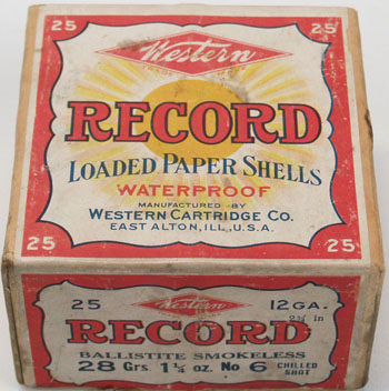

Not really true. SAAMI specs for shotshell pressures came into effect circa 1925. Granted some slight changes due to the transition from LUP to PSI. According to some DuPont Smokeless Shotgun Powders booklets by Wallace Coxe from the late 1920s and the early 1930s, the heaviest 12-gauge bulk and dense smokeless powder loads offered during the first thirty years of the 20th Century were higher then now allowed. They state that these were 12,600 pounds --
LEADER 28-grains Ballistite, 1 1/4 ounce shot
Leader 28-grains Ballistite 1 1-4 ounce #4CH.jpg (55.18 KiB) Viewed 5883 times
RECORD 28-grains Ballistite 1 1/4 ounce shot
RECORD 12-ga 28-grains Ballistite.jpg (76.08 KiB) Viewed 5883 times

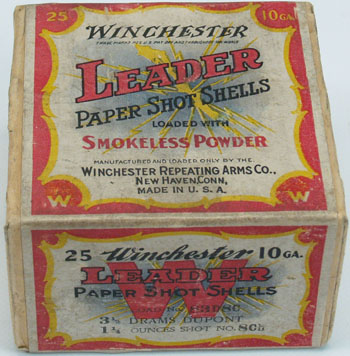

And these were about 11,700 pounds --
LEADER 3 1/2 drams DuPont, 1 1/4 ounce shot
The introduction of progressive burning smokeless powders in the early 1920s allowed that 1 1/4 ounce of shot to be moved out at considerably higher velocity and lower pressures.
